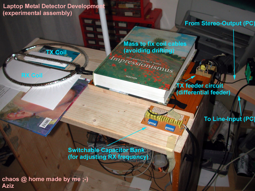

            No, I am not using either Troy-5 TX oscillator nor any other TX oscillator. I am using the differential TX feeder shown in the previous posts.
            The search coil consists only of:
            - TX coil + stereo TX feeder (2 x 10 Ohms current limiting resistor + 3 capacitors)
            - RX coil + resonant capacitor
            That's all what I am using at the moment. No external electronics. External oscillators are not stable enough for lock-in amplifiers.
            TX and RX coils are made on a 20 cm diameter pot and bend to D form type shapes. TX coil has 2*30 windings (center tapped coil, 3 Ohms total) and RX coil has 140 windings (~60 Ohms). The current through the sound-card output is probably 2 x 20-30 mA (roughly). I can not measure the current through the output due to high operating frequency (sorry, I have no oscilloscope yet). My multimeter can only measure currents up to 1 kHz. This also counts for voltages. Maybe I should measure this with my PC scope one day.
            The output voltage is: 2 x 1.4 V rms (differential stereo mode, volume set to maximum).
            Output impedance: ~20 Ohms (earphone output)
            Input voltage range: 110 mV rms (set to maximum sensitivity/amplification).
            Input signal is fed into line-input (10 kOhm impedance).
            RX signal is dependend on the balanced position and can be between 5 mV to 90 mV rms. So this detector will work also with very bad balanced coils. A minimum RX signal level is necessary (let's say 1 mV rms).

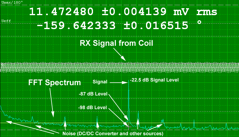

            • Here is a picture of the frequency spectrum and time-domain signal on my HD sound-card. It is not compareable with standard 16-Bit sound-cards. No jittering and timing problems on the signal. This is the reason for my breaking the limits.
              Aziz

                            • This is my laptop MD. Ok it's not operated with a laptop but a PC.
                              Aziz
