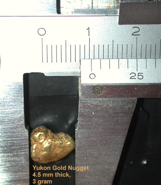

                • Gold Nugget Detection Depth:
                  The following gold nugget can be detected at ca. 20 cm distance (air-test). It is a quite compact gold nugget: ~10 mm length, ~7.5 mm width, ~4.5 mm thick, 3 gram from Yokun (Alaska).
                  Laptop detector without external amplifier. Driven in stereo-mode (differential feed). DD coil shown above.
                  Important behaviour found:
                  Even the lock-in magnitude output (signal output level) is not changed much or not, there can be significant lock-in phase change detected. Both magnitude and phase signals must be processed for a good detection and discrimination!
                  Aziz

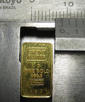

                    • Amazing laptop MD
                      It is absolutely amazing that you can get such results with just the laptop and no external electronics.
                      Attached a 1gram fine gold bar. Detected at 25cm air test with the coil sitting on a pile of fired clay bricks.
                      Tinkerer
                      • Hi Tinkerer,
                        Tinkerer
                        this is a nice yellow specimen. Such plain "nuggets" can be detected much easier. They have a bigger coil coupling area (target is a coil). Compact natural gold is quite difficult to detect. I have not optimized my configuration yet but investigating further. Some more centimeters are sure possible.
                        I need such a nugget for tests! I will go to the bank and ask for this type of yellow.
                        Aziz

                            • Gold test standard
                              Hi Tinkerer,
                              Aziz
                              The Alaska nugget is a more realistic testing target, but since there are no 2 nuggets the same, it could be better to use an universal standard for testing.
                              US and Euro coins are good standards. For gold, I can not think of a more precise standard than the 1 grammer depicted.
                              Tinkerer
