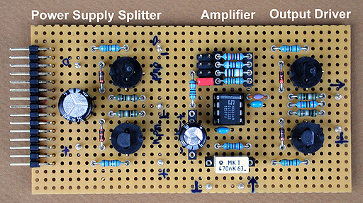

  • I built the following ear phone amplifier (NE5534) for driving the TX coil. I will test this circuit and will let you know, whether it makes sense to drive the coils with more current.
    I found the schematic from this site:
    http://www.audioattic.de/projects/small_eaton.html
    Aziz
    • Shame on me! I have forgot to remove the short circuited input from my last lock-in experiment with one turn coil and was wondering about the strange behaviour of my amplifier on the PC scope!
      Now the amplifier works perfect. Amplification factor x 5. Very low total harmonic distortion until Vout =2.4 V rms AC. Power supply at 10.5 V.
      Now focusing in using the amplifier for TX coil.
