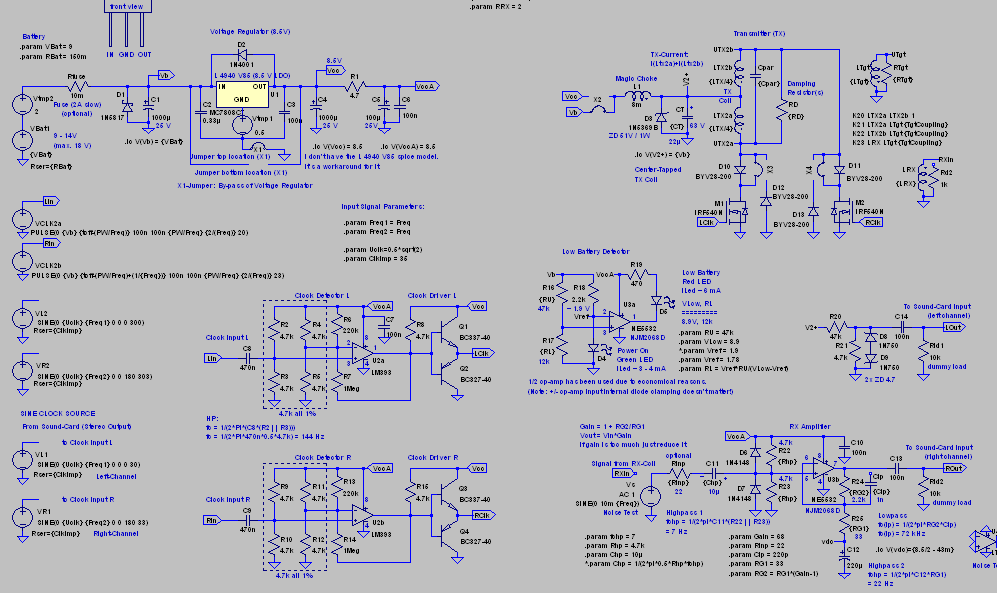

        • Preliminary schematics of the current IB-Hybrid VLF/PI project:
          (Don't blame me please. It's a KISS-design and it needs testing and parts value fine tuning yet. )
          Cheers,
          Aziz
          PS: Notice the magic choke!!!! *LOL*

                "Majik Choke": 2 mH - 8 mH (ring core)
                (not critical)
                If you can wait, I'll post a working spice file soon (next week probably). I have to make a prototype and test it first.

                • Hi all,
                  this is the latest schematics and LTspice simulation file for all the impatient blokes out there (zip file below). You can play with it and can see how it is working.
                  (Trivial, very trivial, shame on me, it's really very trivial.)
                  IB-Hybrid-VLF-PI-4212-V0.01.zip
                  Who is going to make the open-source project now?
                  (Don't look at me! I would cause the total thermo nuclear melt-down to the industry! *LOL*)
                  I have to make the prototype yet. Minor changes could happen.

                  • Perhaps you could use this LDO model - I made it just for you. It is designed as a hierarchical model, so when you open a test circuit, just right click on a regulator, and open a schematic so that you can tweak it the way you like. You'll find a surprise there, a level 2 switch. It has a very neat transition which lends itself perfectly for this purpose. It has a .2V drop in a model, and .2ohm series resistance to mimic 0,2V per ampere drop. And it converges very fast.
