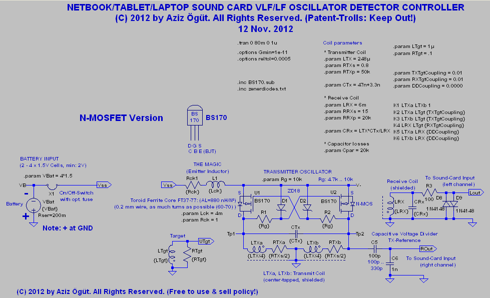

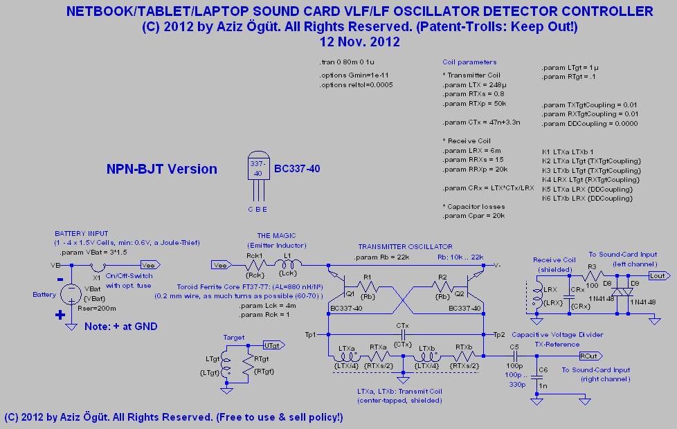

          • The KISS Artwork: VLF/LF Oscillator Detector Controller
            Hi all,
            I'm going to disclose two different VLF/LF Oscillator Detector Controllers now.
            You don't need more parts. You don't need a complex circuit.
            All you need is love!
            1. NPN-BJT Version
            Minimum voltage: 0.6 V (yeah!, that's a Joule-Thief *LOL* )
            Maximum voltage: 4 x 1.5 V (6 V)
            Reverse polarity protection:
            The built-in reverse polarity protection is limitted to the max. Vebo voltage (5V specified). The typical values are higher (measured 8V .. 9V) so it is even protected to 6 V input voltage (4 x 1.5 V). Above Vebo, both transistors conduct and start to heat until they get damaged. Short time reverse polarity does not damage the circuit.
            Recommended operating voltage: 1 - 2 Cells (1.5 V .. 3 V)
            Schematics:
            Spice File:
            SingleFrequencyOsc-VLF-1-4CellArtwork-npn-03.zip
            2. N-MOSFET Version
            Minimum voltage: 2 V
            No built-in reverse polarity protection due to the inherent diodes in the mosfets. Both mosfets do conduct and start to heat until they get damaged. Use either a fuse or a series diode (1N5817) at the battery input. Short time reverse polarity does not damage the circuit.
            Recommended operating voltage: 2 Cells (3 V)
            Schematics:
            I have built both circuits and they work really fine. The n-mosfet variant is more power efficient, which I like to use it. I'll show you the pictures of the circuits soon.
            Notice: The (+) connection of the battery is connected to ground (GND)!
            Disclaimer:
            Free to use & sell. Patenting not allowed!
            Cheers,
            Aziz

                  • Power Consumption Mosfet Version
                    Hi all,
                    I have measured the power consumption of the n-ch mosfet version with 4 charged Ni-MH accus (4 x 1.3 V = 5.2 V). It consumes almost 9 mA. (Rough calculation: 1000 mAh/10mA = 100 h, 4 days long, yeah! )
                    But it gives incredible high sensitivity and depth performance. The mosfet version runs more stable either.
                    The circuit is so small, that all parts can be placed either in the coil or at the bottom coil shaft nearby the coil. Yep, a SMD version would make it much smaller of course. The batteries can also be placed either in the coil shaft or somewhere mounted along the coil shaft (long 2 cell AA or AAA battery holder). Only the stereo line cable is going to the Netbook/Tablet PC (sound card input).
                    Preferred coil configurations (due to their simplicity):
                    - Double D/OO coil
                    - Omega coil
                    - Two-box coil
                    TX-coil: center-tapped, high Q (low resistance, 200 µH .. 500 µH total inductance, i.e. at both coils ends measured)
                    RX-coil: single ended (high inductance, 1 mH .. 10 mH)
                    Both shielded to GND.
                      Huh, something long awaited. How much "mA" with other version?
                        With the same set of batteries (4 x 1.3V = 5.2V): 18 mA.
                        You see, that the BJT transistors & base resistors do cause some losses. The mosfet variant is clearly an advantage.
                        The only critical part is the one-day computing Netbook/Tablet PC: allowing only 6-9 h of operating time duration.
                        I'm also thinking of adding an RX-amplifier later (for the anti-interference coil configurations with superior sensitivity). For this purpose, I'm going to steal some energy from the coil to make the step-up former for the bipolar op-amp power supply. It doesn't matter, when there is some load on the oscillator. I have the TX reference signal to compensate for all the (negative) actions happening.
                        Oh yes, a low voltage battery can generate enough voltage for the op-amps. I have to limit it even not to damage the op-amp.
                        Cheers,
                        Aziz
