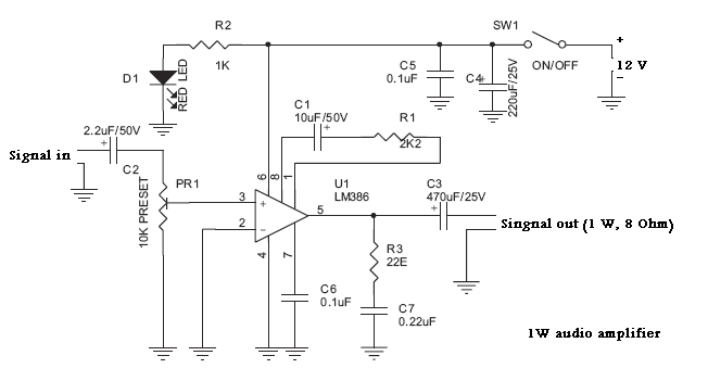

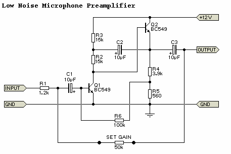

                          Hi AZIZ,
                          I found this schematics for audio amplifiers for Tx and RX,
                          did these good for this job?
                          Please help me about coil that good for this purpose...
                          Thanks... with best regards.
                            Hi Vistac2000,
                            I am using the TDA2040 Hi-Fi power-amp IC. Even this IC provides up to 20 W, I am not using the full range. But the electrical characteristics are well enough. The output power depends on the supply voltage and impedance of the output (speaker/coil). Also you have some reserve of output power for experiments.
                            See TDA2040 data sheet and circuit:
                            May be there is a better IC now. Just look on the web.
                            For the input signal, just use a low noise op-amp circuit. This is quite easier to develop.
                            Aziz
