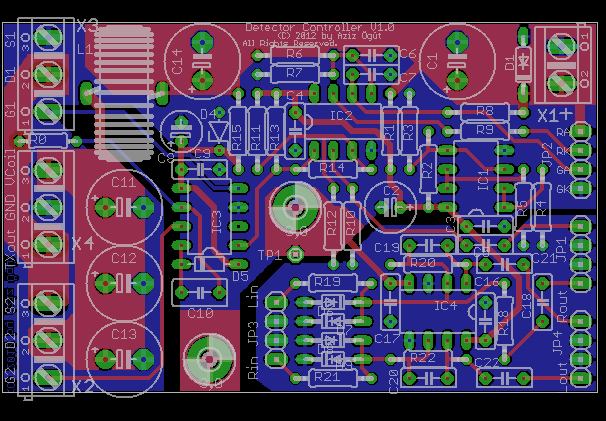

    Hi all,
    I'm trying to reduce the circuit complexity further so I can get four PCB boards onto one 160 mm x 100 mm EURO size board. This is very important to me as I can save a lot of money by the PCB manufacturing. The width of the PC board is already fitting into 80 mm. Let's work on the 50 mm height now.
    The circuit isn't critical and we can leave some big capacitors and some resistors.
    - reducing the transmitter buffer capacitors (overkill not necessary)
    - removing one buffer capacitor (overkill not necessary)
    - removing the gate resistors (not required)
    - re-arranging the layout to use more space
    If I can achieve a 80 mm x 50 mm PCB layout, I would be happy. Let's look, how good the coil connector and the mosfet's fits into a 50 mm PCB height.

          • PCB
            Hi all,
            it seems, that I could fit 4 PCB's into a 160x100 mm board size. Re-arranging saves more PCB space too and it would make the PCB in the production phase cheaper.
            Let's wait and see how the single 80x50 mm board goes and let decide later, which one should be followed.
            Please, be patient.
            Cheers,
            Aziz

              • Small PCB's: Good News!
                Hi all,
                I have good news: the schematics fits into a 80 x 50 mm PCB size now.
                Yeah!, I'm happy this time (it's getting cheaper now).
                I have removed one TX buffer electrolytic capacitor and the two gate resistors and have achieved a reasonable layout by a re-arrangement (no vias).
                Now optimizing the layout further. I will run a small prototype production series next month (at least 8 PCB's). So there is no reason to hurry up at the moment.
                Aziz

                  • Preview of New PCB
                    Hi all,
                    this is the preliminary version of the new 80 x 50 mm PCB. Haven't checked it yet.
                    Cheers,
                    Aziz
                    PS:
                    WM6: Not required.
                      Hi all,
                      Nice design. Well arranged. Did you use auto-placer?
                        Hi WM6,
                        I think, Eagle isn't capable to support auto-placer. (Does anybody knows?)
                        My steps:
                        Manual placement, auto-router using a script file (with given order of nets) and final cosmetics made by me.
                        Yup, I like the new layout too.
                        Aziz

                          • PCB Layout Fine Tuning
                            Hi all,
                            I'm doing the fine tuning of the PCB layout. It is almost finished. The design-rule-check (DRC) passes.
                            Some of the PCB manufacturers let make their PCB's in China. Unfortunately, it takes 2-3 weeks (cheap version). Perhaps, I should look for a Chinese PCB manufacturer.
                            *LOL*
                            Aziz
