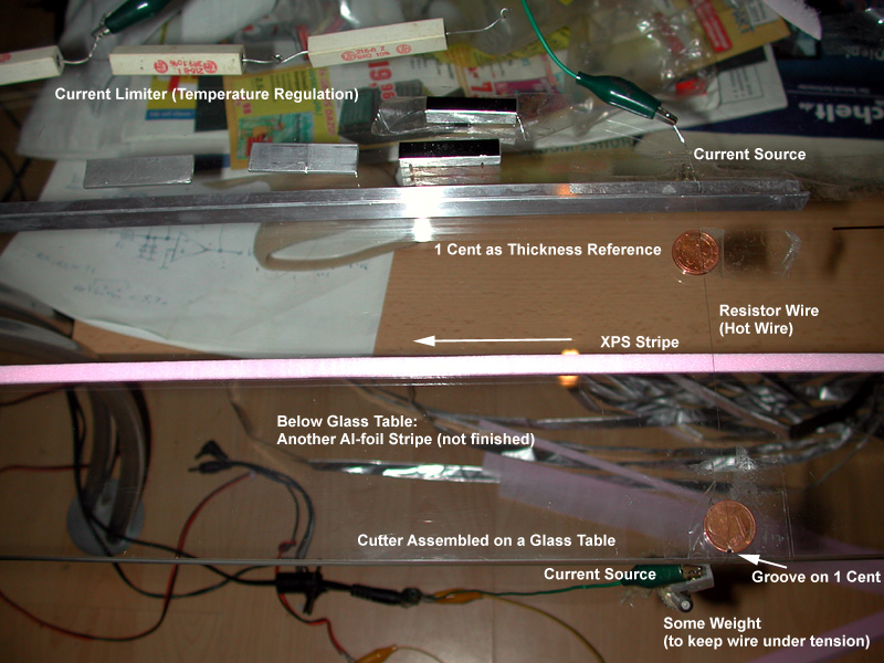

        The best material is still the polystyrene. This is a mass and cheap product, which can be obtained as big sheets. It must be cut into the desired width and thickness and all the stripes needs to be fixed together as a "polystyrene tape".
        I am quite surprised about the easy and precise cutting procedure. One can cut it even into 1 mm thickness. I do not own a precision polystyrene cutter but this cutter can be made quite easy. All you need is a variable power supply, a piece of thin resistor wire, fixing tools and a table. One can cut many stripes in one cutting procedure.

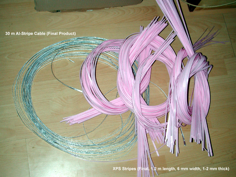

                  • Well ok,
                    I have found, that the new material is an extruded polystyrene foam also known as XPS foam. This material is well destined as a winding spacer with low dielectric constant, which can be cut with a hot thin wire into stripes of individual dimension. It is a mass product for home/building insulations and can be obtained everywhere for less bucks.
                    Indeed, I have cut many stripes till now and it is a funny process. The stripes are well stable.
                    Ok, the coil winding spacer is solved easy and cheap. I am going to fold another Al foil roll and will make pictures of the Al stripe and the DIY polystyrene foam cutter to show you how to do it.

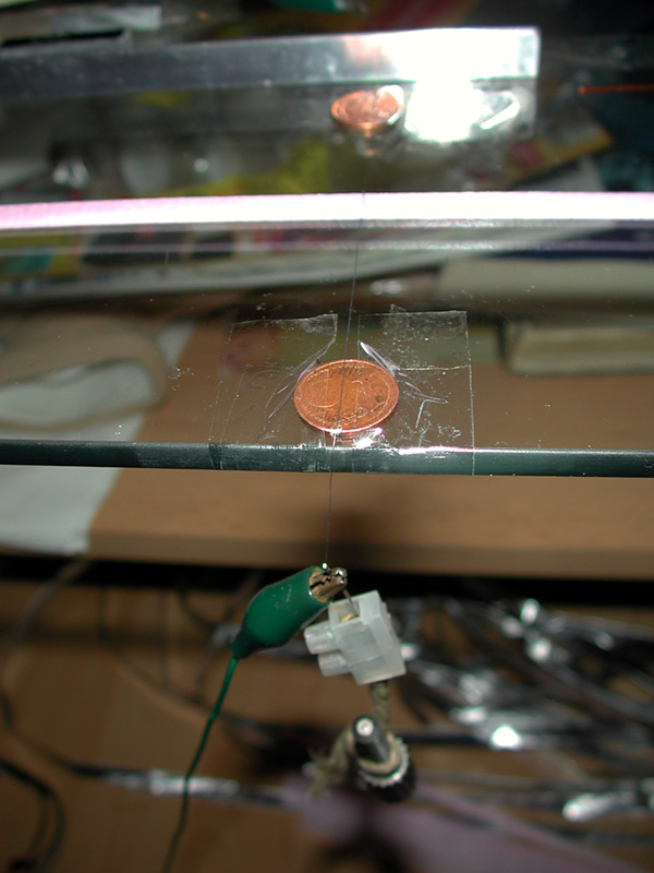

                      • My DIY XPS Cutter
                        See below the pictures of my DIY XPS Cutter
                        Much simpler, much more precise, reproduceable results
                        Powered with 12 V power supply (AC or DC).
                        Damn, I should run to the patent office with it..
                        Cheers,
                        Aziz

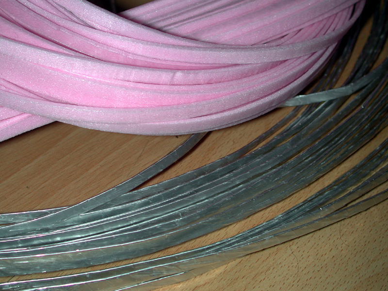

                          What is inside Al-stripe wire? Is Alu stripe wound around polystyrene stripe core?
                          So you use polystyrene stripe twice: as body for Alu stripe Wire and as interwinding insulation spacer?
                            I am sure you will get patent on this great titanium work.
                            Hi WM6,
                            inside the Al-stripe is nothing. The Al-foil is folded always at the center. After folding it six times (!), you get a stripe of approx. 5 mm x 1 mm x 30 m. Imperfections in folding process increases the Litz-wire effect (more air between the Al-foil layers, 2^6 = 64 layers). The Al-stripe is then isolated with a simple and thin transparent Tesa tape. It's giving effectively two layers of Tesa tape isolation. The isolation will give the Al-stripe more mechanical stability.
                            The polystyrene tape is only for isolation between the Al-stripe layers to keep the interwire capacitance low.
                            Aziz
                                Cheers,
                                Aziz
