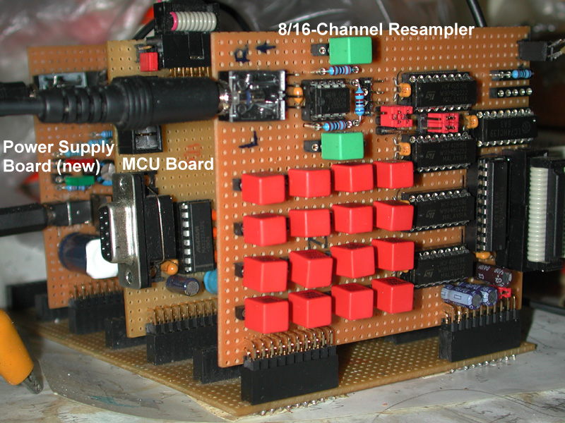

            • Ultra high speed soldering!!!
              Bzzzzzzzt. Finished!
              Am I quick? The quickmaster?
              Just kidding. I was running the boards (see below) for several weeks. I have just changed some chips.
              The MCU board is from the PI Controller project.
              The power supply board is completely new.
              The PI Resampler board is also new and is working fine.
              I need now a simple PI switcher (mono coil). This is missing yet.
              Aziz

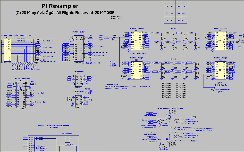

              • PI Resampler circuit
                This is the PI Resampler circuit (overview only). Sadly, the resolution is not big enough to see more details at this moment. But it should show only the architecture of the circuit.
