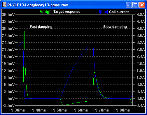

        • Hi all,
          my solution (problem above) seems to work stable and well so far. It supports also a negative voltage for a pre-amplifier (if necessary). A fraction of the flyback voltage will used to get the negative supply voltage.
          To have more target signal stimulation, I will increase the flyback voltage upto 200 V or 400 V. The IRF9640 (P-MOS) seems to be a good alternative, which makes a 200 V flyback voltages possible. The higher the flyback voltage, the higher the target stimulation. But the P-MOSFET's aren't much higher voltage rated and they generally have more on-resistance on higher drain-source voltages. I think, 200 V flyback voltage should be high enough.
          Below is the target induction voltage (green) vs. coil current (blue). Now we should be able to detect the tiny longer lasting signals with the slow ADC better. A DD coil configuration gives a much higher signal dynamic range.
          Aziz
          • Question is: is slow damping as sensitive to presence of target as fast damping (change in pulse)?
            -SB
            • Hi simonbaker,
              -SB
              a good question. Slower damping causes lower target signals (as shown above). But they last longer, which can be sampled longer (slow ADC). Therefore an alternating damping will be used. On every alternating cycle, the damping will be fast and slow and I can get both strength response of target signals.
              And we have oversampling!!! This will increase our SNR much (like box-car integrator method). A much higher pulses per second (PPS) can be used (1000-6000 PPS or more) at cost of more power consumption (why not).

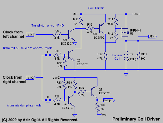

              By the way, I have reduced the circuit complexity. The alternating coil damping needs now only one zener diode and one additional P-MOSFET (same as for transmit coil switching).
              Below is the current coil driver circuit (not optimized yet). The clock signals are coming from the clock generation module (not shown yet). The switchable damping is now very vey simple (not shown yet).
              I need to build this prototype to say more. I am sure, it will give some basis for experimenting.
              Aziz

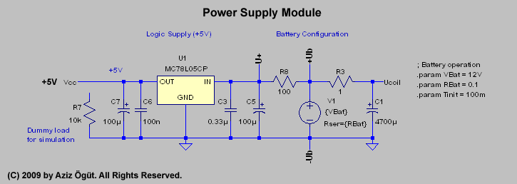

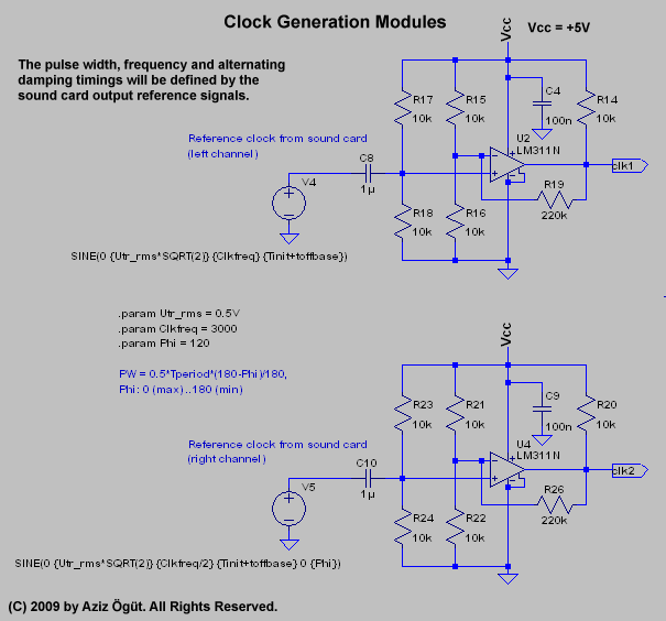

              • Hi all,
                I am thinking of adding a two channel single stage amplifier to the PI board. This will give the option of increasing the signal dynamic range. The two channels (left/right) can be used for different configurations.
                The AC amplifier will work from a single +5V power supply and will be biased to 2.5V level. The bias voltage will be generated from a reference voltage bandgap diode to minimize the power supply noise. A single supply rail-to-rail op-amp is necessary. I found the OP284 as a good choice but I don't know, where to get it.
                Below is the first part of the schematics: Power supply module and the two channel reference clock generation modules.
                The reference clock is a pure sine wave from the sound card output and will be converted to a 5 V logic. To avoid noise to the clockings and prevent the logic signals to get into unstable oscillation state, a minimum hysteresis voltage is required (30-50 mVpp). The hysteresis is defined by the feedback resistor (220 kOhm). If there is no reference clock on the input, the coil won't be switched on and the logic levels are stable (default state).
                Depending on the operation mode, the transmit pulse width can be adjusted. If the alternating damping is not used, two different pulse width modes can also be used with different reference clocks. The phase shift of the reference clocks will be used to set either the pulse width or the time position to start with alternate damping.
                Using two reference clocks will give more flexibility to the PI board.
                I will focus now to the amplifier.
                Aziz

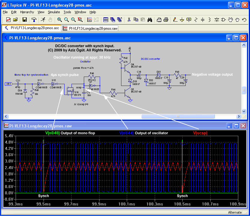

                • Hi friends,
                  damn, it is very difficult to get single supply, low noise rail-to-rail op-amps. Bipolar supplied op-amps achieve a much lower noise performance and are easy to get. The common mode has also some benefits to signal conditioning.
                  The negative control voltage for alternate damping won't be generated from the flyback coil voltage anymore. This will improve the signal quality further and avoids additional non-linearities (no additional load to the damping process).
                  A free running discrete DC/DC converter with synch input will be implemented therefore. The schematics needs some redesign.
                  Aziz
                  • Hi all,
                    the clock generation modules and DC/DC converter will have a CD40106 schmitt-trigger inverter. I didn't use the ICL7660, as this chip is only specified upto 10 V operating voltage (). The A-grade up to 12 V. I also want to run the DC/DC converter at much higher frequencies than 10 kHz. Last but not least, I couldn't find a spice model for this darn chip.
                    Therefore a well designed discrete DC/DC converter would give more accurate and well specified behaviour. The DC/DC synchronisation will synchronise to the clk1 by discharging the oscillator capacitor to ground. This ensures accurate synchronisation of the free running oscillator. The higher operating frequency (30-100 kHz) will also generate the negative voltage faster. See below for more details.
                    The system supply voltages will be +UBat (12V battery voltage), +U (RC-filtered +UBat), Vee (appr. -9 .. -10V from DC/DC converter), +5V and -5V. I also will add a reverse polarity protection to the schematics to avoid circuit damages.
                    The pre-amps will be a dual NE5532 or any other low noise op-amps.

                      • Hello friends,
                        I want you playing with some spice circuit simulations. Load the latest LTSpice version IV and set to alternate engine after installing it.
                        LTSpice IV download:
                        http://www.linear.com/designtools/software/#Spice
                        Unpack the zip file below into a directory of your choice and load the schematics file "LaptopPI-01-DC-DC-converter.asc".
                        See how the DC/DC converter and reference clock generation modules works. The DC/DC converter runs at 50 kHz and synchronizes to 3 kHz reference clock 1. The synchronisation takes some time until a steady state is achieved (capacitors loaded, stable operating points on nodes estabilished).
                        Have fun with circuit simulations.
                        Aziz

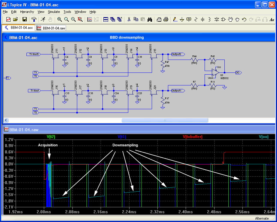

                          What about the time multiplexing? Use hardware to take 4 fast samples, then multiplexer at different clock rate to read them?
                          -SB
                          • Hi simonbaker,
                            -SB
                            the simple BBD schematics below does a simple downsampling. But it can not achieve good SNR. It is a fully differential BBD to minimize the switching and common mode noises. The clocks T1 and T2 may not overlap (break before make). On the decay curve, T1 and T2 is clocked at 500 kHz for acquisition and is downsampled to 10 kHz. The circuit is quite simple compared to a S&H amplifier and can be stacked to more buffers.
                            I think, the former presented stereo modulator will do the job much better.
                            I will test the direct sampling first to make the whole circuit simpler.
                            Aziz
