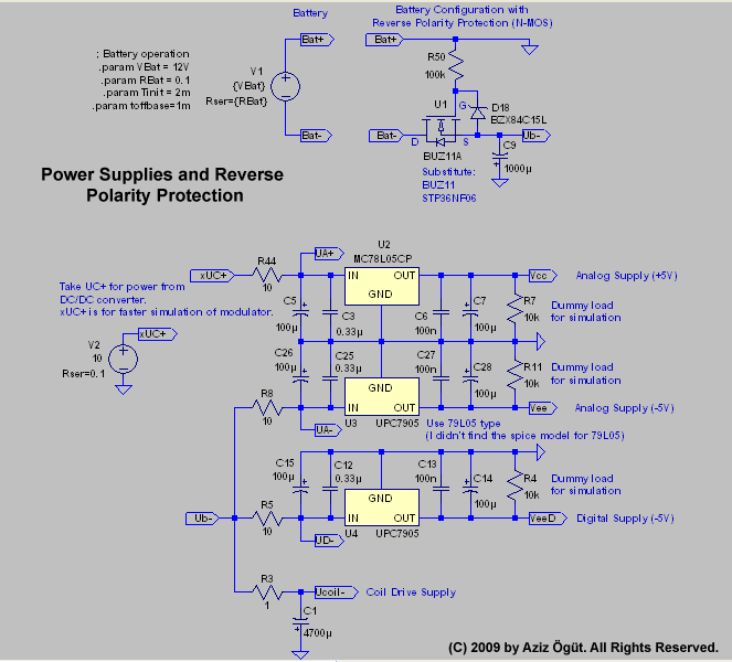

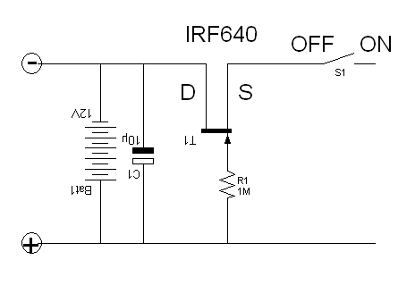

            • Hello aziz, good work ,
              I show you my protect polarity circuit i use in my detector
              work very well without loss
              Have nice work
              alexis
              • Hi Alexis,
                thanks for your hint. Indeed, this little circuit works perfect. I had already similar solution with additional mosfet gate protection using a zener diode.

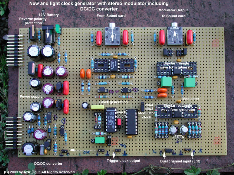

                    • Hi all,
                      the new board with power supply, DC/DC generator, clock generator and stereo modulator is finished now.
                      It seems, that I have reduced further noise and power consumption. The whole tests are not finished yet and I would like to see the signals with the scope soon.
                      I took a voltage divider on the analog power supply lines with a potentiometer for the input voltage. It is interesting, that normal potentiometers produce greatly much noise than a 10-turn wire potentiometer. To test various single and dual op-amps, the board has three IC sockets per stage.
                      The OP27 op-amps show the improment but have more current draw. The NE5532 works also fine with less current draw. The clock signals seems to be much more stable compared to LM311.
                      To be continued...
                      Aziz
                      • Here is the new board.. much quiter than the previous version and
                        allows µV detection.

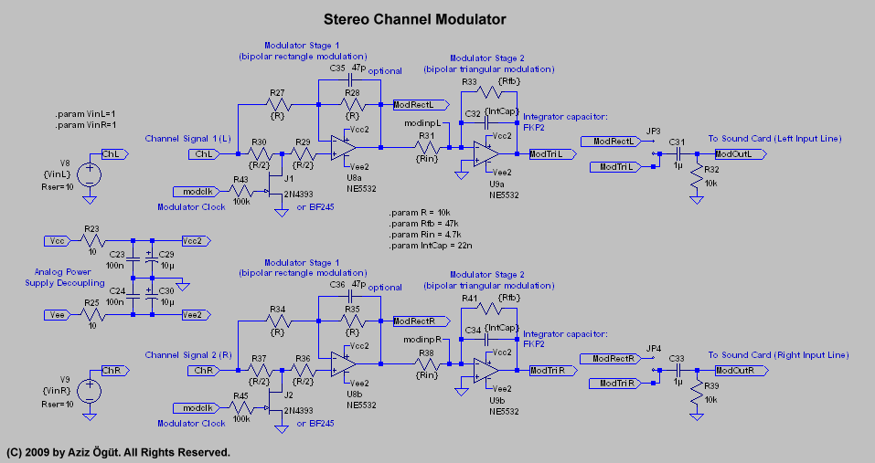

                        • Hi all,
                          the modulator is working really fine (like frozen scope output, very quiet). I will optimize the circuit for 6 kHz clock (modulator at 3 kHz) and 1 V rms to the sound card input. The triangular modulation response is frequency dependent. The higher the frequency, the lower the output. This is typical for integrators (the last stage is an integrator).
                          We can use the dual op-amps NE5532. The OP27 isn't worth for the marginal improvement.
                          If I have finished the optimization, the complete schematics with the spice simulation files will be available for educational purposes.
                          Aziz

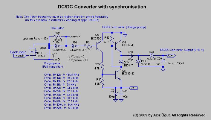

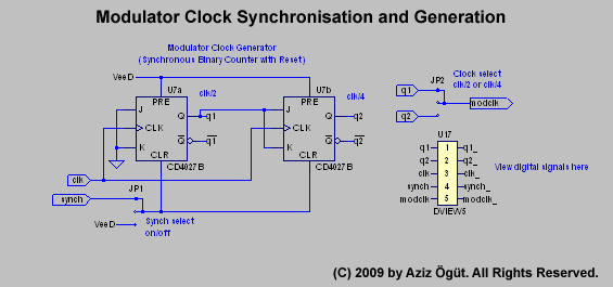

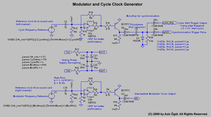

                          • Complete Schematics of the last module!
                            Hi friends,
                            Although not all tests are finished yet, I will publish the schematics of the new board now. It consists of the following parts:
                            - Power supply, Reverse Battery Polarity Protection
                            - DC/DC Converter (synchronizeable)
                            - Clock Generation Modules
                            - Modulator Clock Divider (synchronizeable)
                            - Stereo Channel Modulator
                            The clock frequency of the DC/DC converter may differ to real circuit. So adjust the oscillator resistor and/or the capacitor for your requirements. The capacitor should be FKP2 or polystyrene one. A clock frequency between 30kHz to 100kHz should be ok. Resistors should be all metal film (1%).
                            The stereo channel modulator can be extended to modulate two channels more. In this case, the bipolar rectangle wave form modulation can not be used. But there is no need for this at the moment as I only want to use two independent channel processing. You can use NE5532/TL072 or compareable dual op-amps. There is also no need for JFET-input op-amp.
                            If you don't use the synchronisation of the modulator, then the polarity of the encoded channel signal cannot be determined except you feed a defined voltage to get the signal polarity.
                            Left channel of the sound-card output is reserved for cycle triggering and synchronisation (DC/DC converter and modulator). Right channel is for the modulator clock. The modulator clock will be either half or the fourth of the feeded clock frequency (jumper selection).
                            The new board makes the use of sound-card signal processing possible now. You only need to feed two DC signals into the modulator. The generated internal noise is acceptable and gives satisfactory signal decoding.
                            More to come..
                            Aziz
                            • Hi again,
                              now the spice circuit simulation files of the last PC sound-card interface modules will be available. I have lowered the DC/DC converter clock frequency to make the simulation faster. The positive supply voltage will therefore be fed from a fixed 10V supply. The simulation takes quite long time.
                              To make a full spice simulation of all parts, change the DC/DC converter clock frequency to the desired operating frequency and feed the UC+ into the +5V regulator.
                              Set LTSpice into the "Alternate" engine. Whole parts of the presented modules are now the PCPI sound card interface module.
                              Aziz
