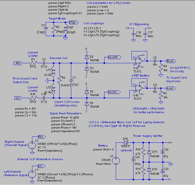

    Hi all,
    this easy design makes true mono coils possible. Below is a differential mono coil for better performance. It shows only the principle and must be optimized further of course.

        you should decide, which type of detector you want to develop.
        1. PI
        The AD converter of the mentioned PIC is very likely not fast enough for PI systems. PI systems need at least 1 MSPS (Mega samples per second, 1 µs resolution). Using Flash-A/D would be better but expensive.
        2. VLF
        For VLF you do not need such a PIC. Just use the stereo input and output of the Laptop. You will have at least 16 Bit at 48 kHz or even with the common new Laptops 24 Bit at 96 kHz sampling rate.
        10 bit A/D: SNR ca. -30 dB (in the PIC)
        24 bit A/D: SNR ca. -72 dB
        SNR increase on 24 bit A/D: 42 dB!!!!
        Forget any suggestions with any PDA's. You will have much more problems with it (tools, compilers, specs., etc.).
        Implementing the code on Laptop would be very fast and easy. You will have enough number crunching power for this purpose.
