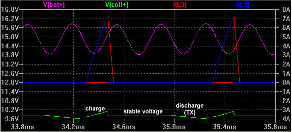

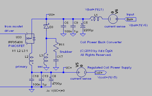

                  • Simple Buck Converter Principle
                    Hi all,
                    below is the discussed very simple buck converter principle. It has up to 92% peak power efficiency. The mosfet driver and the switching logic (flip-flop, comparator, etc. ) is not shown here. The coil is a typical transformer wound on a ring core ferrite.
                    I probably will use the LM319 dual voltage comparator as it is fast enough (80 ns), cheap and easy to get. The most delay comes from the mosfet driver and mosfet itself. A switch-off response of 250 ns and less should be possible. Switch-on characteristics is not critical and can even be much higher (1-2µs).
                    I have not finished the full schematics yet and I am considering to use the buck converter also for the power supply section to maximize the power efficiency further. I hope to get a wide input voltage range (9 .. 28V).
                    Aziz
                    • Voltages and currents (see below):

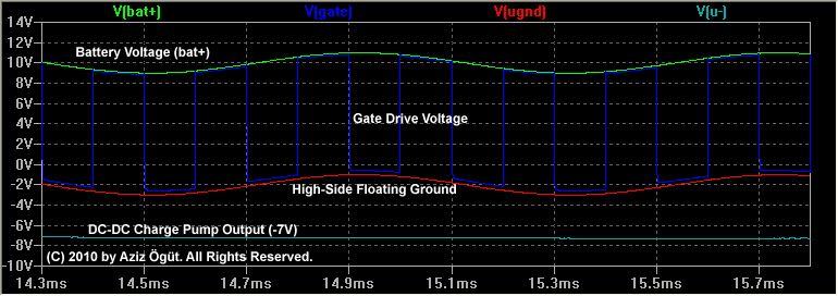

                      • High-side nch-mosfet or pch-mosfet driver?
                        Hi friends,
                        regarding the coil power controller:
                        I have reduced the switch-off time down to 170ns (with p-ch mosfet Si4401DY having 37 nC gate charge). Following dumb calculation: 80ns comparator + 20 ns flip-flop + 70 ns mosfet-driver and mosfet switch-off. It was a discrete high-side p-ch mosfet driver with fast switch-off optimisation (3A switch-off peak current!).
                        Generally, the high-side n-mos drivers operated in bootstrapping mode won't cut off the switch current instantly and the coil power supply is capacitively coupled to the driver. I have tested the LTC4440 in the circuit simulation and it hasn't the benefit compared to the discrete p-mos solution.
                        So a high-side p-mos driver is most convenient for this application. Nevertheless, low-side drivers can still be used in the high-side configuration. Indeed, I have several MCP1407 (6A mosfet driver), which I would like to use it. The logic input signal must be level shifted up to the high side and a high-side gate power supply is necessary, if I want to go down to 9V input voltage. Due to the lower input voltage of 9V, the mosfet gate voltage is limitted to 12V or 15V (not anymore 18V). A charge pump inverter will support the switch-on of the p-ch mosfet with negative voltage converter.
                        The high-side power supply for the mosfet gate driver is critical and must be stable enough (have to float with the input voltage). I will use either the 79L12 (-12V) or a discrete -15V solution or even a low-drop negative regulator. This will ensure same gate voltage drive even the battery voltage diminishes or changes over time.
                        Input voltage: min. 9V, negative charge pump could deliver -7V: Total span: 9+7=16V. This should be high enough for the 79L12.
                        Using low input voltage and high gate drive voltage makes an own power supply for the mosfet driver necessary. Fortunatelly, these circuits need not much power and we can use linear regulators. We also need it anyway to regulate the main power supply. Most power draining parts will be efficient down converted.
                        So I have to change the power supply section completely to be efficient enough and make a wide input voltage range possible (9V .. 28V) . It will very likely the most complex part of the detector.
                        Aziz

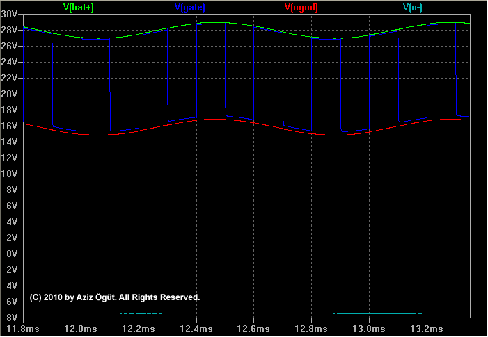

                          • F$!%$!§$& The 78xx/79xx are driving me crazy .
                            I want to have high input voltage possibility at any cost (up to 28V)! But getting closer to the absolute maximum ratings (input voltage), the regulators won't work well. So I can not go with the input voltage up with the 79xx regulator. The DC-DC charge pump can deliver max. -8V (-7V regular). The 79xx has -35V maximum input voltage range. There is also some span necessary to get this regulator work well (lets take max. 27V limit according to recommended operating conditions mentioned in the data sheet).
                            The max. input voltage would be:
                            Vinmax = 27V + (-8V) = 19V
                            That is definitely too low.
                            Ok, there are other options:
                            1. Using the LM337 regulator (up to -40V)
                            2. Discrete solution (up to -40V)
                            I have choosen the discrete solution. It makes marvelous precise, low power consumption, low noise high-side regulator possible. Have a look into the floating gate voltage (below). I probably can go with the input voltage even higher than 28V.

                            • Forgot the upper limit input voltage behaviour:

                                Have a look at capacitor C9 (1µ)!!! Drop the damping resistor R10 (1k), the snubber resistors R24 (420) and R25 (100). And we have the basic powerful coil transmitter.
                                Let's continue with this project until I have some money for the PI controller. To be continued ..
