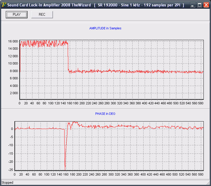

        Sample Rate: 192000 Hz
        Sine Frequency: 1000 Hz
        192 samples per 2PI (one wave)
        Conclusion: Sound-Card can NOT be Metal Detector

            Please, do not compare GPR with IB Metal Detector...
            Sound Card Sample Time is the problem... This time is unknow
            This time is Phase and Amplitude error(noise) -
            big time - big error
            Low RX - very big error

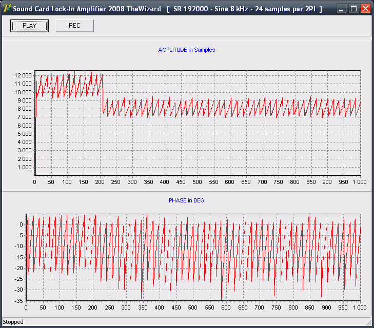

            atachment:
            Sine Frequency: 8000 Hz
            24 samples per 2PI (one wave)
            TX - 1 watt speaker
            RX mono microphone
            RX ~= TX
            if you work with Sample Rate 44.1, 48 or 96k - what will be error...

              atachment:
              TX - 1 watt speaker
              RX mono microphone
              RX ~= TX
              Your attachment shows a sawtooth kind of signal with a DC offset not a sine wave. What am I missing?
              You have to be more specific, what kind of error?
              Again, I do not agree or disagree with you. I just don't understand your conclusions and therefore I'm asking.

                ...What am I missing?
                screenshot show The Amplitude of input sine wave signal with freq. 1kHz and 8kHz
                Sample = Offset + AMPLITUDE * Sin (x * 2Pi)
                "Phase in Deg" is phase difference between Transmited Sine Wave (TX) and Received signal (RX)
                ...what kind of error?
                Error form Amplitude and Phase calculations.
                EXE calculations is double float
                synchronization and the latency between TX and RX is 0
                Sorry but my Englis is bad and I can not explain exactly and in details....
