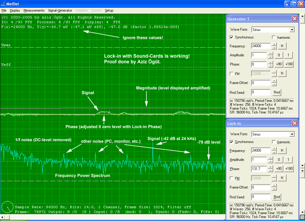

            Lock-in with Sound-Cards is working!
            I will comment this later. It is too late now!
            Aziz
            • #66
              Some comments on my last Lock-in experiment on Laptop/PC with Sound-Card:
              IB-Coil (PCB-Coil) with high impedance connected directly to sound card output (left channel). IB-Coil is not fine balanced. The signal is the minimum possible balanced signal given only by the PCB-traces of the coil.
              RX coil is not shielded and will show a high level of broadband induced noise. Also no amplifier is connected to the RX-coil. RX-coil is connected directly to microphone input (microphone amplifier is on) and the sensitivity is set to max.
              There is a phase shift between TX and RX signal physically.
              Sampling rate is 96 kHz, 24 Bit resolution. Signal frequency is 24 kHz.
              Despite of the high operating frequency and only four samples for one wave of signal, the Lock-in output is responding to any phase and amplitude changes very sensitiv and quite stable. More better results than I had with very small bandwidth FFT-filtering methods.
              The Lock-in method allows shorter filter bandwidths of filtering the signal of interest. And this goes by far further than FFT-filter or any other filter. So there is much more potential of detecting even very small signals buried in high noise.
              Lock-in should be also applied on PI's. There are some ready-for-use IC's on the market or can be easyly implemented on a RISC µC/DSP. Of course, on the Laptop with ease.
              I will do some more experiments with signal levels from mV to µV. Also will connect an amplifier to RX signal and will watch the response. There is more to discover.
              Aziz

                Can you make graphic/diagram of phase and amplitude - some like my soft....
                • #68
                  Amplitude is colored magenta, phase is colored yellow in the time-domain. Due to low-pass filtering of I (Y) & Q (X) channels, you see almost the DC level of the values. If you are interested, I can also show the pure I & Q channels before filtering (after mixer), after filtering (realtime I & Q channels), etc. It is interesting to see, how lock-in amplifier is working.
                  Aziz

                    I want to know how is phase noise amplitude in DEG
                    in my picture - phase(and I & Q) have not filtering - it is "RAW" data from AcrTan2 function and amplitude Sqrt....
                    in my second pictures phase noise is big from DC offset - soundcard problem... and I use microphone and speaker... it is audio/room phase reverb

                      TheWizard,
                      the reason for lock-in is to eliminate the noise. After having multiplied the signal with Reference I and Q, you have to low-pass it. We are not interested on noise amplifiying. We are only interested on the pure signal on specified frequency. My low-pass filter is a very sharp FFT filter at 0 Hz with some bandwidth.
                      The noise can be seen on the FFT-Spectrum. It is typical for my worst case coil configuration (very noisy environment). Even with a bad sound card, it should work anyway!
