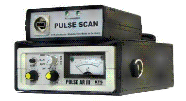

          Hello Aziz , Everyone, We should move this thread to the top of the page under "Project Ideas" !!! Anyway this Usb ADD-On Device can make some Money !!! A German Company KTS sells a PI-COMBO Unit For $3600.00 Euro !! WOW. And you look at the photo of the pulse detector and again you ask "Discrimination" REALLY" ???? . All I can see on the bottom unit is an intensity meter , no Lcd display . It could be "Equivelent in Power to Delta Pulse" !!. The top unit has a USB port , so it must be just a Deluxe 'Video Card" for a Lap-Top !!!! And I am sure there is some version of software for the Lap-Top....... Aziz , I am sure If you or all of us together designed a " PC Based analyzer with a Video image "COMBO-UNIT" For even $1800.00 Euro ,it would "CONTROL THE MARKET"......... $1800.00 Euro to US DOLLAR is Still good money Today !! .... .......RIGHT ??.......................Eugene

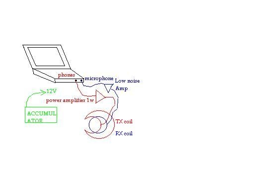

                  Using an external LC oscillator makes the design very easy and only one sound-card is necessary. The total estimated external hardware cost for the laptop MD will be in range of 10-20 Euro.

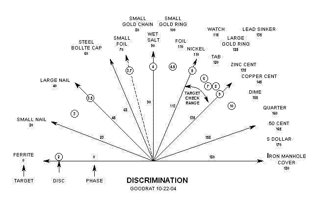

                      Aziz, Digital Phase Shifting Algorithym and then to a Lock-In amp. circuit is 100 % possible. My idea is of a Band-Pass filter for each type of target on the chart below and then to a Lock-in amp circuit !! But this will not work in Europe where the coins are made different. Gold would work anywhere but not bronze coins .......Just another idea.....Eugene

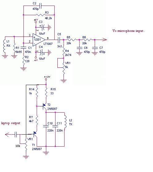

                          Aziz ,Was this your Design ??? IF not I think you may have seen this a couple of months ago , but just in case , here are the photo's from another posting. Anyway my main interest "NOW" is P.I. discrimination . And I think this will become a reality soon with 100% accuracy. But it will take working with D/A conversion and Waveform shaping of the signal , both on the transmit and recieve circuits. And I believe the search coil must have a separate TX winding and a separate RX winding . NO EXCEPTIONS !!! A single coil will not work even with micro-processors.......Take Care........Eugene
                          • Hi Eugene,
                            this design is not my own and I saw it month ago and I didn't need it. My laptop MD even worked without amplification of the RX coil side. I just put the sole coil with matched parallel capacitor to match to the operating frequency of the TX side.
                            On the TX side I tried many external oscillators (difficult to lock in to the frequency) and power amplifiers or just low noise buffers. It will work in any configuration with more or less stability and performance. Using very low noise LC oscillators (+high stability) could bring here the best depth and performance.
                            I have combined the Lock-in amplifier with a Boxcar integrator and this brings the best performance and stability.
