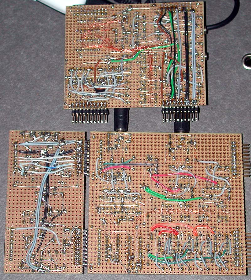

  • Hi Simonbaker,
    quite awful wiring on the back side. But there is some order. It is not optimal but does the job at the moment. Digital control lines are made with thin magnet wire (solderable).
    Aziz

        Thanks Aziz -- it is good, shows me what can be done.
        Another question: when you use the magnet wire, do you need to strip the enamel with a knife or something, or does the heat melt and expose the copper for the joint?
        -SB

          the enamel is melting during soldering. The wire is destined for this purpose. So it isn't a common magnet wire. But makes the digital wiring fast.
          Aziz

            Thanks Aziz. I would like to get some wire like that. Is there a specific name or brand?
            -SB
            • I use Magnet Wire, too. It was advertised as "solderable".
              Well, my old simple Iron was too cold to solder it,
              so i had to buy a (cheap) Soldering Station that goes up to 450 C.
