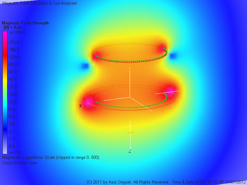

        • Magnetic Field Cross-Section
          Coil upside down now (the right operating orientation).
          • Hi all,
            according to the magnetic field cross-section view, one can exactly see, where to set external parts (screws, coil stem mounting, coil cable, tuning capacitors, etc.).
            That's the small region with the two blue points nearby the RX-/TX-Bucking coil. Well, this is a ring-region with less EM field of course.
            Aziz

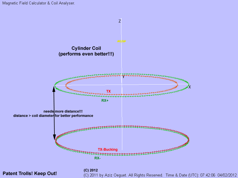

                  • Breakthrough Modification
                    Hi all,
                    the sketch below is illustrating the first modification I have suggested:
                    Bigger RX+/RX-/TX-Bucking coil. Below is the 1.2 times radius of TX coil. It works very very nice (better than the original design). But it needs more distance of the coils as illustrated below.

                    • Hi Aziz,
                      What do you think of adjusting the gain of the cancelling rx coil preamp? Then you could have a smaller cancelling rx coil at the same inductance and just increase the gain until it cancels the emi from the rx coil. Or would you prefer the cancelling be done before the preamps? I tried making a 25" rx coil for my 25" mono on the weekend, but the wire I used was not suitable it was detectable by the tx coil. I have some litz here might have to try that.
                      As far as the gap (height)between the rx coil and the cancelling rx coil I believe it would not have to be too far above. 10~20cm would be sufficient. A weak signal will be detected in the rx coil but not(or only a tiny bit) in the cancelling coil. A strong signal will be somewhat cancelled by the cancelling coil, but there will still be a signal none the less. You will never entirely loose the signal unless the 2 coils are too close together. The other advantage is that it will cancel out some strong ground signal as well
                      Cheers Mick
                      Cheers Mick
                      • Originally posted by Mechanic View Post
                        Hi Aziz,
                        Cheers Mick
                        Cheers Mick
                        Hi Mick,
                        sure you could do that. With minor disadvantages (higher amplifier noise, not perfect EMI cancellation..). But it would in principle work.
                        It is always better and easier to build identical RX coils. TX-Bucking coil should be placed as close as possible to the RX- coil (high inductive coupling coefficient).
                        But the latter coil proposal above is nice, very nice and I'm very very amused.
                        Aziz
