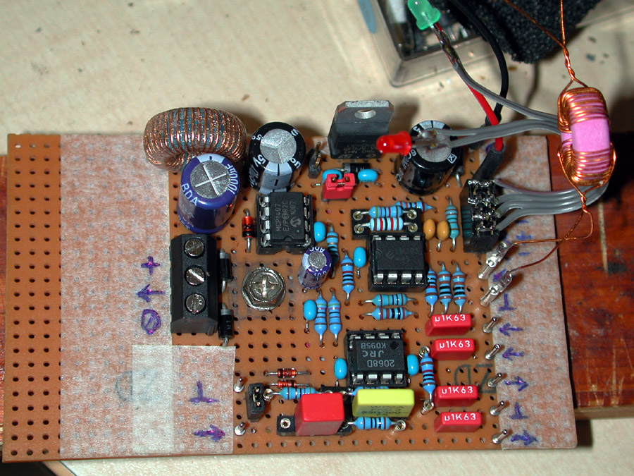

                • Hi all,
                  that's going to be a very nice dual-frequency detector controller (see below). Even the transmitter parts should fit into the case easily. Pity, that the parts haven't been soldered yet. I'm doing the manual placement of the parts at the moment. Why post it here? Well, if I incidental drop it, I can look how it was before.
                  Cheers,
                  Aziz
                  PS: The second pic is showing one of my earlier prototypes (IB-PI Detector Controller V1.2 I think. I have to change the inverting pre-amp into non-inverting pre-amp yet.)

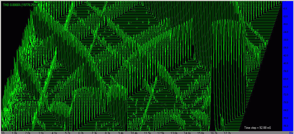

                    You can see the FFT spectrum "swinging" left and right
                    I know, only I'm not sure whether it is a function of software or a soundcard itself.
                    I used this software to learn about my soundcard performance regarding aliasing etc. I introduced a sweep from 20Hz to 20kHz and a 3D (kind of waterfall) spectrum display with linear frequency. Well, after what I've seen I am in pursuit of a better soundcard. Xonar or something.
                    (artifacts are seen as a mesh of lines going everywhere)
                    • Aziz
                      nice job!
                      good idea putting the resistors in a socket !
                      Philip

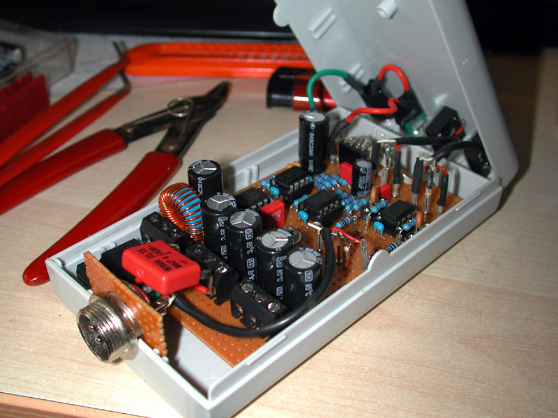

                      • Dual-Frequency VLF Detector Controller finished
                        Hi all,
                        that's it, I just finished soldering and it is working very nice so far.
                        I haven't plugged in the transmitter yet. But I have looked at the output: very clean and stable rectangular pulse so far. I had to use an audio-transformer for measurements (right inductor) to avoid power supply short-circuit due to virtual ground potential (CRO & sound-card are sharing the same earth ground line).
                        When I have more time, I'll test it with the transmitter and coils.
                        Cheers for now,
                        Aziz
                        • Yep, very nice!
                          Hi all,
                          well, I couldn't wait to see it's working. It's going to be a smart & nice Killer-App (for it's simplicity and low-power)! The transmitter is very stable with the internal H-bridge driver of the mosfet-driver this time.
                          I have connected a 10 Ohms resistor between the transmitter and mosfet-driver so the mosfet driver doesn't get much hot. Well, it seems, it isn't even getting warm. I could very likely put more power to the TX coil. The total battery power consumption is almost 50 mA at 10-11 V. The TX coil voltage is approx. 35 - 40 Vpp.
                          I'll watch the TX power drift due to diminishing battery voltage more deeper, whether the LDO (8.5 V voltage regulator) is necessary or not. I have made the LDO switchable active/inactive by just exchanging one jumper (see above picture).
                          Oh man!, ground balancing get's quite easy with the dual-frequency VLF.
                          Cheers,
                          Aziz
