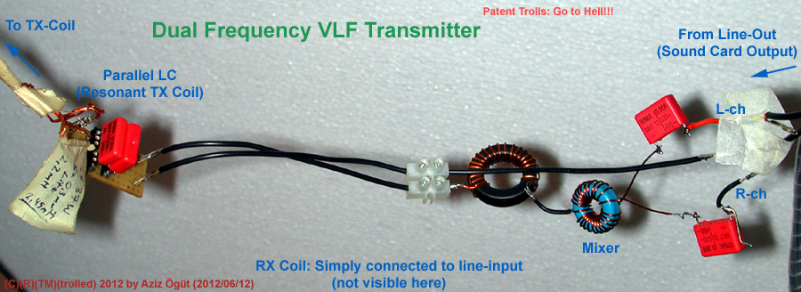

  • The Dual-Frequency VLF Transmitter
    see pic..
      see pic..

          • Versatile Passive Dual-Frequency Transmitter
            Hi guys,
            did you see the clever (inductive) mixing of the TX driving sources? It's quite versatile:
            - driving with dual channel sources (each frequency on its own channel, total TX power is summed together)
            - driving with mono channel source (both inputs connected to the same source, the mixer inductor eleminates (almost) itself)
            The active booster module can be either a single channel (simple & low cost) or a dual channel (stereo, doubling the TX power). The passive transmitter module need no changes...
            Aziz
            PS: Do not forget, that the transmitter is also able to transmit a chirp waveform!!!!!
            • Bad News.
              Hi all,
              I have connected the passive dual-frequency transmitter to the latest detector controller in the h-bridge mode (both mosfet's connected). Unfortunatelly, the low frequency switching isn't stable and producing therefore noise (you can even hear it in the detector controller). The high frequency switching is stable. Also when I set the low frequency switching off the resonance frequency, it's getting more stable. In the chirp switching mode, one can exactly see, when it gets unstable.
              Well, the topology of the mosfet-driver with the bootstrap-circuit is critical for dual-frequency transmitter. Fortunately, this is the only configuration, that makes switching unstable. Other coil configurations work well.
              I'll try (yes, I'm a "trial & error"-"engineer" ) a different h-bridge topology to see, if the switching is more stable this time.

                  • Ok guys,
                    I'll plug a small bi-polar driver stage to the output of the detector controller soon. Let's see, whether it gets stable in the dual-frequency transmitter. It will take some time due to getting fine weather and week-end time.
                    Cheers,
                    Aziz

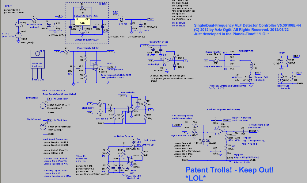

                            • Single/Dual-Frequency VLF Detector Controller (preliminary circuit)
                              Hi guys,
                              I am willing to make the following single/dual-frequency VLF detector controller circuit (see below). The mosfet-driver (MCP1407) should give a little bit more power compared to the line-out of the sound card. If this isn't enough, one can plug additional driver-stages at the output of the mosfet-driver of course.
                              I just have modified one of the previously published detector controller version. So it's looking quite similar to it. I have added a 8.5V LDO voltage regulator and the circuit is intended for low-power/low-voltage operation (9-10 V input).
                              If this circuit works well, I'll remove the H-bridge part of the previous detector controller and add some improvements to it.
                              Cheers,
                              Aziz
                              PS: Sorry for the small circuit picture. I have a low resolution display (1024x768 ) .
