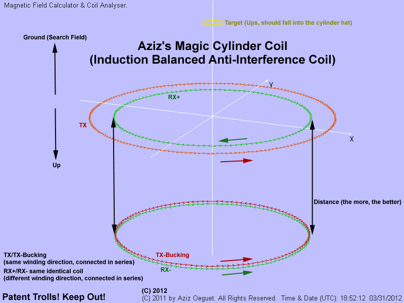

        • "Aziz's Magic Cylinder" is Born!
          Hi all,
          you may call my new coil Aziz's Magic Cylinder! (*LOL*)
          It's sooo easy to build (amateur's heaven). It's sooo easy to balance (IB). It's soooooo quiet (fully anti-interference coil). It's going soooooooooo deep. It's enabling sooooooooooo big coils.
          It's simply pure magic.

                        • How To Connect the Coils?
                          to be continued ...

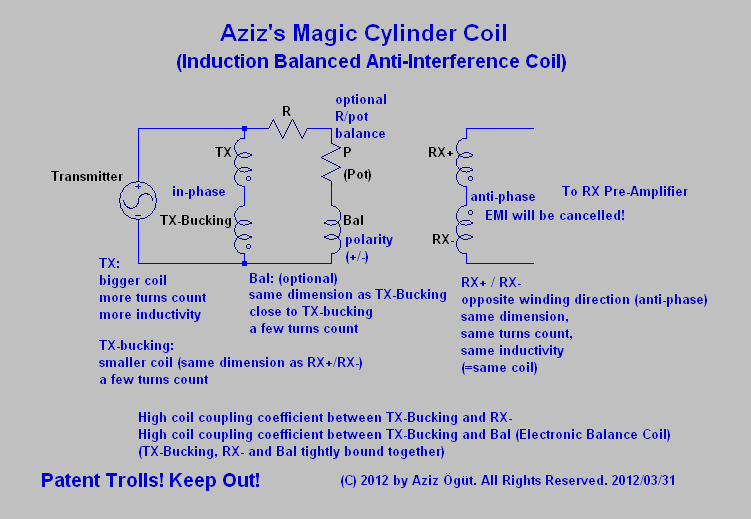

                          • Hi all,
                            I'll write more detailed infos later how the magic coil works. The shown coil above is only an example of course. You can make the outer TX coil much bigger of course (getting almost a ground loop coil *LOL*). Or the inner coils smaller. Or vary the distance. You can use spirally wound TX coils. You can use rectangular (frame) coils instead of round coil. Or elliptical.
                            On your imagination, there is no limit.
                            Aziz
                            • Hi Aziz,
                              What happened to the KISS method,this is one difficult coil to make when one can use a figure eight coil for the same result
                              Where we are in Cue, Western Australia we have very little EMI(Population 27 so the only EMI we encounter would be thunderstorms
                              Which brings me to the point,when you have one up and running send it over and Sherri and i can give it a run for it's money(testing it of course!!!)

                                Hi all,
                                Aziz

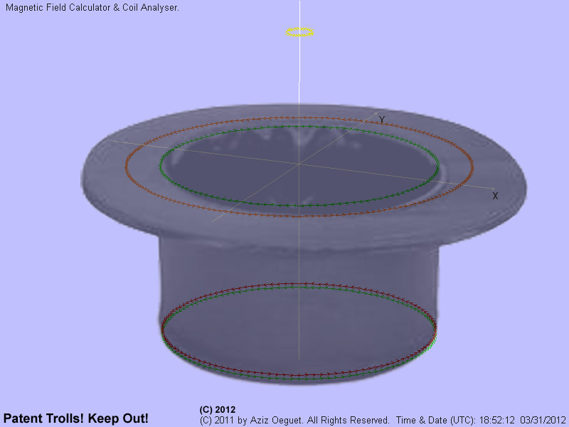

                                Damn you Aziz! You stole my idea!
                                Lol, it was probably hints from you that got me thinking about it anyway..
                                But yeah its brilliant. Anti interference, no bucking coil field partially cancelling your main TX and unlike the coaxial coil you can get your RX and TX right up next to the ground.
                                Win, win win!
                                I'll have to get rich some other way..
                                BTW I'm pretty sure we have to call this a 'Top Hat Coil' No other name is going to stick so well.
