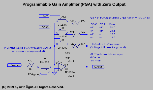

        • Hello friends,
          I want to propose the following programmable gain amplifier for this project. It is an inverting type, which amplifies the target signal from the pre-amp. It uses three control lines:
          PGAgate:
          off (-5V): Forces the PGA to zero output for software adjustments (offset voltage errors) and avoiding the saturation of the PGA op-amp. When the gate JFET is off, it is a typical voltage follower for ground (zero volt).
          on (0V): PGA works
          PGA0, PGA1: Switches the different feedback resistors for different gains. Keep attention, that this amplifier inverts the input signal.
          The reason for the inverting type of PGA is as follows: The JFET's can be switched easier due to inverting input pin of the op-amp (pin 2), which is a virtual ground potential. The source pins of the JFET's are connected to this virtual ground potential. A voltage of -5V on the JFET's gate switches the JFET's off, and 0V on.
          The PGAgate (input JFET gate) has also a temperature compensation function. The Rdson (switch-on resistance of JFET) will have then same temperature behaviour on both feedback and input path, which are compensating temperature dependend amplification drift. Of course, if I would have more control lines, I would offer J1 a seperate control line. But I have to save control lines. Four different amplification factors should be enough at the moment.
          The input resistance of the PGA is 1k (=R30). The reverse transfer capacitance of the JFET's (Crss = 5pF) will limit the bandwith slightly. It is also a welcoming effect of reducing high frequency noise. It is anyway reduced by the 47pF capacitor (C10) in the PGA.
          The amplification factors (feedback resistors) may be changed during the development. It depends on the pre-amp amplification and other factors.
          Aziz

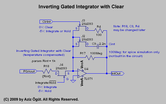

          • Hello friends,
            here is the next proposal for this project: gated integrator with clear. The schematics below is a classical gated integrator circuit. J2 is to compensate the temperatur behaviour of J4 (gate) and can be omitted, if you want to save parts (J2 is always switched on). J3 discharges the integrated voltage, held in the holding capacitor C9 (Cint).
            The integrator needs two control lines: Integrate/Hold and ClrInt (Clear).
            The parts value of R18, C9 and R4 may be changed later. The input resistance of the integrator is 1k ( = R18 ) .
            The 100Meg resistor is only for SPICE simulation and helps to convergate. This will not be used in the circuit.
            The integrator is an inverting type. So the PGA and integrator together is a non-inverting circuit now.
            Aziz
            • Some notes on the discharging resistor R4 of the previous schematics:
              R4 is a place holder in the circuit for the case of beeing set to a high impedance resistor (10k - 100k). Normally, discharging resistor R4 can be omitted due to Rdson of J2 and J3 (~200 Ohm together).
              The high impedance version is for a different operation mode reserved (auto discharging with time constant T = R4*C9). This makes the design more flexible for future developments.

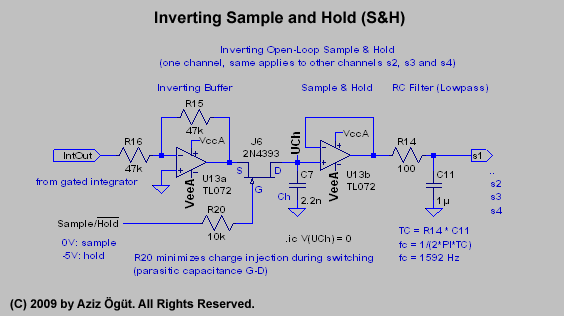

                  • Hello friends,
                    now the sample and hold design is finished. The schematics below shows only one channel. Same applies to the other channels s2, s3 and s4. I strongly recommend to use a dual JFET op-amp (TL072, TL082 or others).
                    The channel output voltages s1, .. s4 will be on the negative rail level. The holding capacitor Ch (2.2nF) must be optimized for fast settling and low droop rate later. As the modulator has an input impedance of 47k, the passive lowpass filter has enough low impedance. The lowpass filter minimizes further noise and voltage settling swings.
                    That was the most important functional parts of this design. Now, the microcontroller with the PI front-end (coil driver + pre-amp) is missing.
                    It is again time to fire up the soldering iron.
                    Aziz
                    • Hi all,
                      I found the following important warning about the JFET's in the internet (see below). If you want to try other configurations, then be aware of this warning. The used gate logic voltages in this project are allways below 0V (0V/-5V). Then a reverse biased diode can be omitted and makes the circuit simpler.
                      Of course, the JFET can be operated with positive gate voltages to lower the Rdson. The gate current must be limited in this case.
                      Aziz

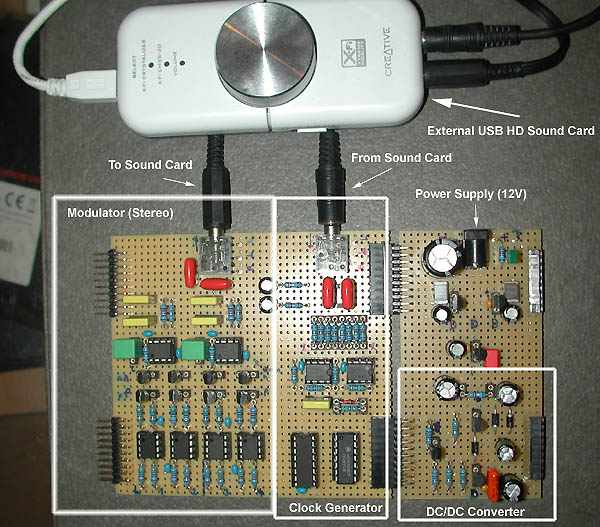

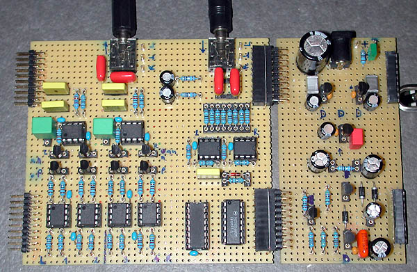

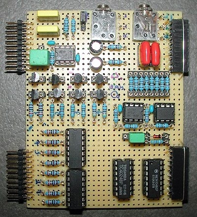

                            • Hi all,
                              I will show you the current state of this project:
                              First photo: my former modulator
                              Second photo: my new stereo modulator and power supply module
                              Third module: new modulator with some descriptions
                              Aziz
                              • wiring
                                Hi Aziz:
                                Can you show the underside of one of the boards and describe how you wire the parts together? I'm interested in how feasible it is to build circuits without making a PCB, what the effort is, etc.
                                Very nice work.
                                -SB
