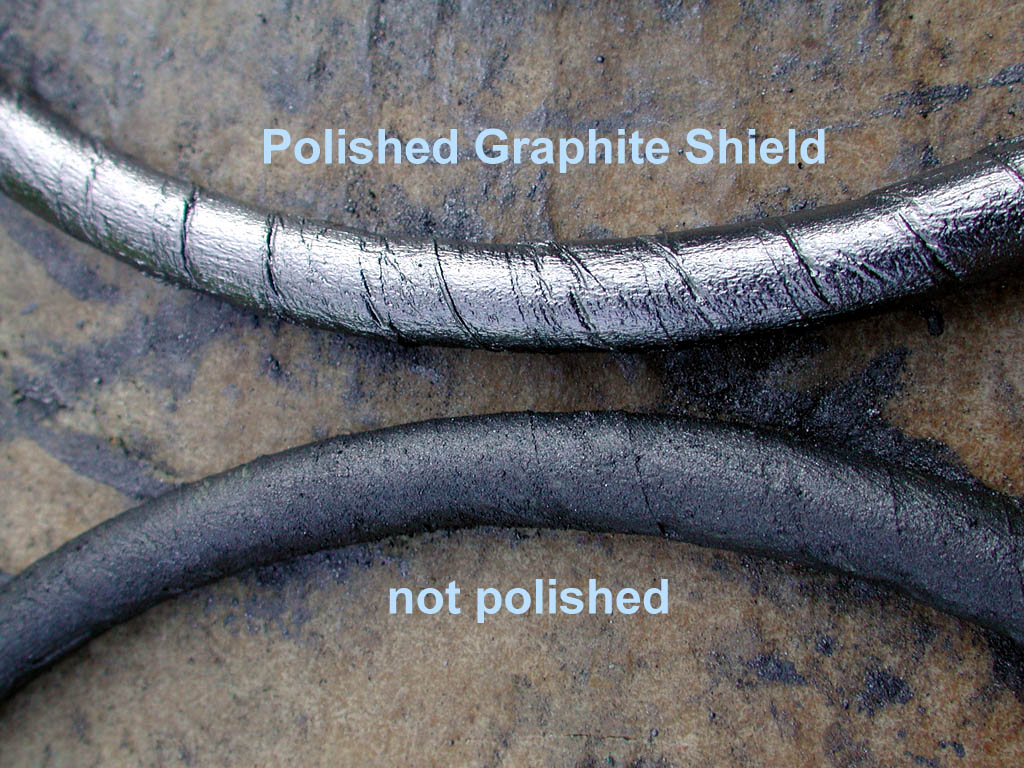

                The graphite resistance depends on many factors:
                - Coil diameter
                - Coil windings diameter
                - graphite shield thickness
                - polished/not polished
                - varnish type (bounding agent for graphite powder)
                Here is some values for my 20 cm coil:
                Before polishing: ~10 kOhm (measured from one point to another between shielding gap)
                After polishing: ~2-3 kOhm
                Graphite shielding causes less eddy current effects. This has more detection sensitivity to targets. The coil can be balanced more exactly to zero (no residual voltage)!
                AL foil has better faraday shield. But causes detection depth losses.
                Aziz
                • To see the difference between polished and not polished, just look below:
                    Hi Simon,
                    - Coil diameter
                    Aziz

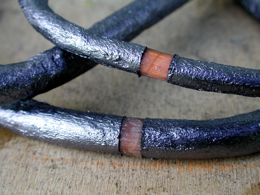

                      Here is a formula for making graphite shielding:
                      One volume part of 2 component epoxy resin, mix well.
                      Add 5 volume parts of graphite powder, mix well, it gets very thick so start adding the solvent.
                      5 volume parts of epoxy paint solvent.
                      1 volume part of colloidal or fumed silica.
                      Mix well and apply evenly with a paint brush.
                      Before application, attach a very thin, bare (no insulation or varnish) copper wire to the coil with a few thin strips of tape.
                      Cover the copper drain wire with shielding paint.
                      Later solder the drain wire to the cable shield.
                      The silica prevents the paint from being runny and gives it some strength, but has little influence on the conductivity of the coating.
                      At first apply a thin coat. Test after drying. Then apply more if needed. 30 to 50 microns is usually good.
                      Make sure to leave a gap, or sand off a gap after drying.
                      Tinkerer

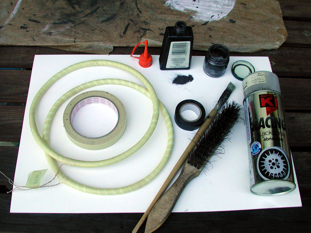

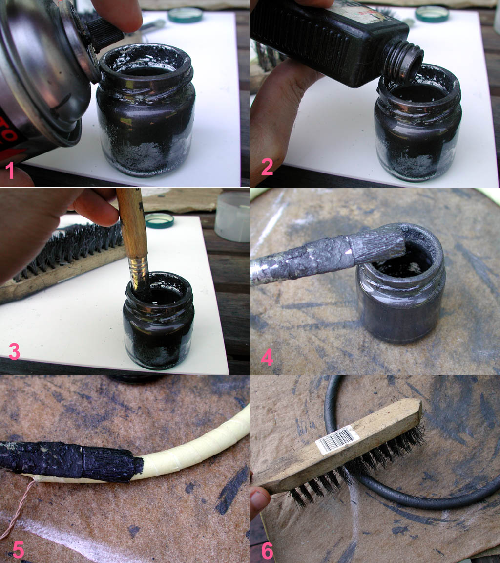

                        • Here is my secret and formula for excellent graphite shieldings:
                          I am using a very fast drying resin (has more solvent) and keeps the graphite more conductive. I have to work quick. So I have to spray more solvent from the spray can if the mixture gets thick-flowing. First the resin, then the graphite powder. Not the other way! Otherwise, you would blow the powder out of the glass!
                          Here some photos of my equipment and corresponding steps:
                          Aziz
                          • Thanks also Aziz for valuable lessons on your graphite shielding. Do you just add solvent by "feel" until it is thick enough?
                            I am always impressed by your (and others, Max, Ivconic) craftsmanship, very neat construction and setup. Thanks for sharing it.
                            -SB
                            • Hi Simon and others,
                              -SB
                              I am mixing only small portions of graphite with the shown varnish spray. The varnish drys very quickly and if the mixture gets thick, I add some into the mixture (in the small glass). The varnish spray contains lots of solvent and therefore drying quickly. You have to try a bit to find out the best viscousity for painting. Normally one layer of graphite is thick enough. But there is no limit. If you like, you can make the shielding thicker.
                              Not all varnish spray types may be appropriate. I have tried some of them.
                              This shown one binds the graphite particles with less varnish and enabling a much higher conductivity.
                              Polishing is quite easy: A metal brush or any other metal stick is moved gently over the coil to smear the graphite. Then the conductivity of the shield increases dramatically. The graphite shield should be protected with some tape finally. Also between two different coils, the shieldings should not touch each other!
                              Aziz
