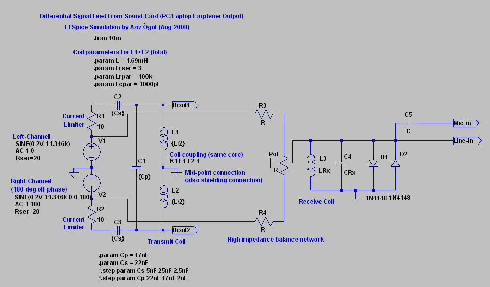

      Phase shift adjustment on a coil for discrimination:
      It is quite difficult to build a perfect coil with desired phase lag and signal level of the RX signal referred to TX signal. The discrimination behaviour will change upon different coil balance position. Once built a coil and fixed this, it can not be changed anymore. You remind, the coil must be very tight (mechanical).
      We can use a simple resistor divider network with a pot to balance the coil. To be able to do this, we have to drive the coil in differential mode (stereo-mode). The resistor divider has linear phase response and gives a good balancing possibility.
      Once the coil is balanced well, it delivers a clear phase shifts between ferro-magnetic and not ferro-magnetic materials.

      Hi Aziz: - would you provide a drawing of this configuration?
      - Also, would you talk some more how you use amplitude as part of your detection, what filtering, etc.
      - Also, would you describe some more on how balancing affects your discrimination? Is it related to the fact that when coil not completely nulled, we are adding two small signals and the phase shift depends on the relative size of the two signals:
      received signal = A1*sin(wt) + A2*sin(wt + theta) =
      == K*sin(wt + phi)
      {A1 is amplitude of residual TX signal from imbalance, A2 is amplitude of
      of target signal with phase shift theta relative to TX signal. We want to detect theta exactly}
      and where the phase angle phi = phi(A1/A2, theta) {some function of amplitutes and phase difference)
      In a perfectly balanced coil, A1 = zero, theta = phi, and we can detect the phase theta with a lock-in amp.
      When not perfectly balanced, phi depends on A1/A2, and therefore it is difficult to determine theta unless you know A1/A2 exactly.
      Hope that is understandable. Interested in what you say.
      -regards,
      SB

          • Hi Simon,
            see below the simple coil and balancing configuration. I have not provided the values of the parts. This have to be matched (depends on many factors). But it shows the principal circuit. When you use the mic-input, then the DC signal from mic-plug must be decoupled with a capacitor (C5)!
            The balancing is quite simple: R3/R4 and the Pot defines the voltage divider and will be added to the receive signal. R3=R4. This gives a bipolar voltage range. The resistor divider must be a high impedance one not to dominate over the RX signal.
            Balancing is easy: Adjust Pot for minimum signal on the RX coil (input signal). If there is a minimum level of signal left, then the coil has some metal parts nearby and can not be nulled to zero. But it doesn't matter. It is better to have some minimum input signal for the lock-in amp (phase is more stable).
            The signal output is:
            Left = A*sin(wt)
            Right=-A*sin(wt) or A*sin(wt+180)
            Thats all.
            Aziz

                      • Thank you Aziz for schematic and description .
                        How fast is phase shifting? Is it steady shift? Can you not estimate it and remove it, or too much processing?
                        Good luck, you are making good progress in spite of the challenges. Even though your goal is laptop MD, your results also help with all MD designs.
                        -SB
