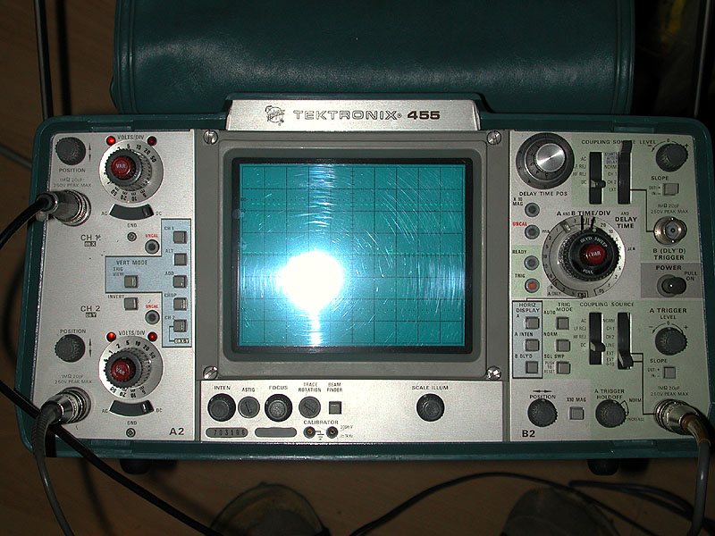

                • My oscilloscope arrived today!
                  It was a good buy: 5 (!) probes included!
                  Some pots needs contact spray or be replaced. Overall a good buy for 151 EUR including shipment.
                  I am very happy to see the signals now.......

                      sure... if you don't see anything can't do much progresses... i hope you'll find it really useful, I'm sure you'll fix it.
                      Then 5 probes are nice add to the whole thing... good having extra available.

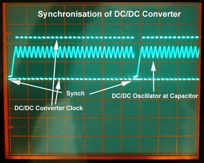

                      • Hello friends,
                        I am quite an unlucky guy last days. The parts I have ordered last week gone back! The postman did not find my door.
                        Nevertheless, I have built as far as it was possible:
                        - Power supply finished
                        - DC/DC converter finished
                        - Clock generation finished (variable pulse width control through left and right channel of the sound card output)
                        The timings are precise enough. Only +/-0.001 degree phase noise at 375 PPS (Hz).
                        My oscilloscope is doing a really good job. I should have had it much earlier. See below my oscilloscope and the internals of the DC/DC converter synchronisation. LTspice is doing also a good job.

                          Your experiences are like a soap opera, very entertaining.
                          Nice oscilloscope, we will expect even greater things from you now.
                          I have the 465, fairly similar. It looks like you have a small hex screw under each channel ac/gnd/dc slide switch - I wonder what that is for? Just mechanical or electrical trim?
                          (By the way, my channel 1 ac/gnd/dc slide switch seems to have come loose and I am nervous to open up to fix it. I am surprised because I have not used it that much).
