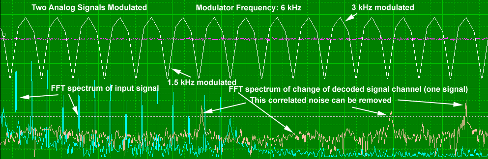

            • Modulator CRO Output
              Hi all,
              the new channel modulator is working very well. The best modulator I have at the moment so far (cheap and easy).
              Below is only one channel output (right line) with two analog signals encoded. Two different fixed analog signals were fed into the modulator. The modulator base frequency is 6 kHz. One analog signal channel is modulated with 6 kHz/2=3 kHz and the other one with 6 kHz/4=1.5 kHz. As long as the dynamic range of the input line is not exceeded, the channel seperation works well (change of one signal channel is not contributing to the other signal channel).
              I have put the change of one decoded signal into the graph (violet color at the zero base line) and its FFT to see the spectrum (gold color). You can see a high frequency noise of the decoded signal, which can be elegantly removed by the software processing. Of course, any correlated noise can be removed. So there is no need for a specific 50/60 Hz filter at all.
              Aziz
