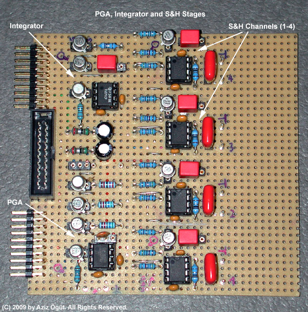

          • Hi all,
            now the PGA, integrator and S&H stages are finished but not tested yet. I will continue with a very simple coil driver and preamp. Pay attention to the red S&H caps (rectangle blocks)! They are FKP-2 types (from WIMA).
            Aziz

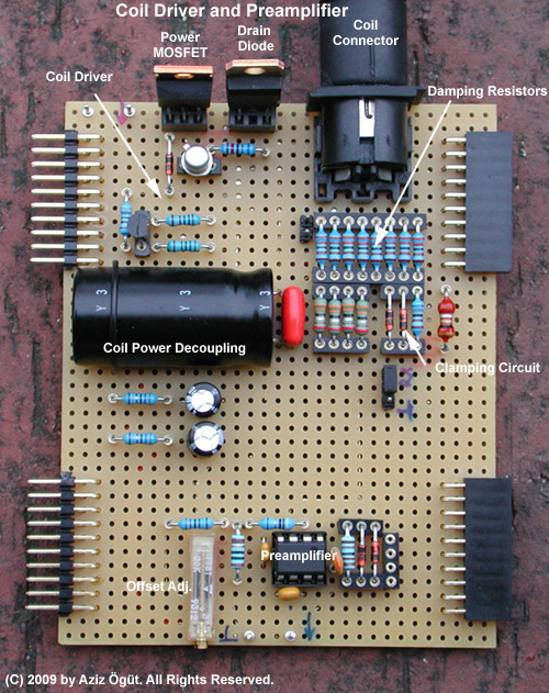

                  • Hello friends,
                    the last module (basic coil driver and preamplifier) is finished now and is ready for starting with the software coding (see below). Now the development will go very slowly as I have to make more tests and software coding. I also have arrived the state, where I need an oscilloscope to go on. This will slow things until I can get one in the coming weeks. Till then, the development will go almost "blind" or with sophisticated measurement methods (without scope).
                    I will replace this module with a better preamplifier later. I just need a reference for the improved version.
                    Aziz

                      Hi Aziz:
                      I like your prototyping techniques and have a question: why are some resistors, diodes etc. mounted on little gray terminal blocks and some directly into the board? And what are those little gray terminal blocks called, where do you get them?
                      Thanks,
                      -SB
                      • Hi simonbaker,
                        Hi Aziz:
                        Thanks,
                        -SB
                        I don't like desoldering parts. The PCB board gets worst on every soldering and desoldering action. All parts, which might be changed in the prototyping are mounted on a precision DIP IC socket pins. I bought many of 40 pin DIP IC sockets and cut them into peaces of 3 (for transistors) or any array combination. Single pin peaces will be used for single resistors or other parts.
                        This makes changing of parts quickly possible by removing the part from the DIP pins without desoldering them. Fixed parts (no change necessary) will be soldered directly to the board.
                        The MOSFET and diode are using a different connector socket (also cut into necessary number of pins) due to thicker wire diameter.
                        Aziz
                        • Hi all,
                          the power consumption of the design meets the < 200 mA limit including the damping resistors and 4 active LED's (but not the TX pulse power). It was a good invest to the DC/DC charge pump, which draws ca. 50 mA at the moment. I took the higher current rated TL082 in the S&H because I haven't any TL072 left. The TL072 are drawing less current and have better performance.
                          Aziz

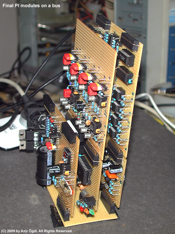

                            • Hi all,
                              as you can see (below), the hardware overhead is quite big. But it doesn't matter for the experiments I have planned.
                              Now, the very big part of the project starts: the soul of the detector (firmware, PC software). So I might be offline for a while.
                              I will continue as soon as I am feeling better (had a relapse of my tooth problem).
                              Take care,
                              Aziz

                                I think you should call this detector "Frankenstein", as it's turning into a monster.
                                But hopefully it won't try to kill its creator.
