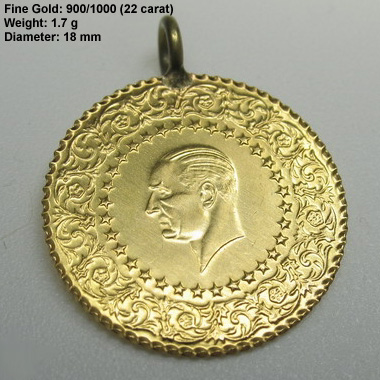

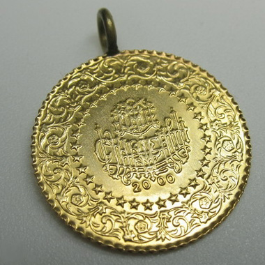

  • I can detect a small gold coin at 36 cm (air-test). Even with discrimination. The gold coin (see below) is a standard size turkish gold coin (1/4 of size, called ceyrek altin).
