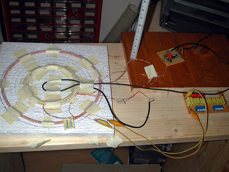

                      • Hi all,
                        I have found interesting behavior on balancing. Neither the electrical balancing network nor the software controlled (inductively controlled) balancing will correct the signal phase shift and signal level behavior. I came to the conclusion that only the additional winding (on RX or TX coil) will do a much better adjustment. Any balancing networks will be discarded. The last correction of the coil can be made purely in the software by transforming the not linear behaviour of signal level and phase into more convenient form.
                        Concentric co-planar coils (CC) are showing a much better coil stability. So the mechanical stability will no longer an issue. Due to the less RX coil flux area on CC coils, the sensitivity will be lower than on DD coils.
                        DD coils needs some extra stability and have to decoupled from the coil housing.
                        Attached picture: experimental concentric co-planar coil assembly.
                        I have now an idea of how to make a good coil. Some tests must be done yet.
                        Aziz
