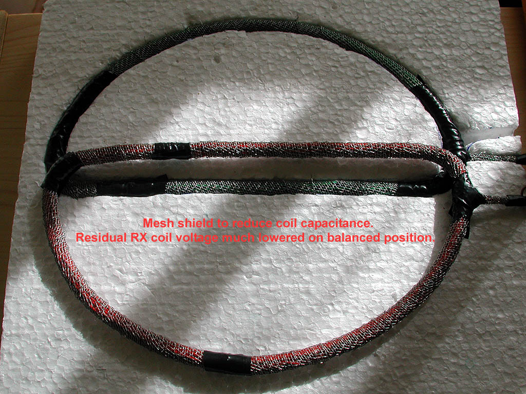

        • Hi SB and others,
          I have made the coil shieldings with a AL mesh wire. Mesh wire is cut into 1-2 cm stripes and wound around the coils. There is allways a gap in the shielding (to avoid closed loops). This will allow to lower the residual RX coil voltage much (see below). This is a practically proofen good fact to lower the residual RX coil voltage.
          But:
          Still have other disturbing effects (hand detection, ground effects) which tend to be a K.O. (knockout) criteria for this project. I have no idea at the moment how these disturbing effects can be cancelled. The lock-in amplifier is obviously too much sensitive for such effects.
          There is no difference between hand detection and ground detection. So the reason must be somehow capacitive or other type. I am sure, the capacitive effects tend to be much higher when measuring ultra tiny signals.
          I will follow the other way now: the brute force method. Increasing inductive effects to dominate over capacitive effects. I will force more current through the coil by switching it like a PI. The switching clock must be derived from the sound-card output. It will be switched in the VLF range (10 - 24 kHz).
          Aziz

            Hi Aziz,
            What are the inductance values for your coils, and do you have any tuning capacitors across them?
            Also - I assume that you have actually connected the shield to the 0V line. Stupid question, I know ... but I've got to ask it.

                • Hi Qiaozhi,
                  Hi Aziz,
                  The above green/black coil is TX coil (center tapped). It has 2x14 windings wound on a 16 cm pot and bend to D form.
                  The below red/brown coil is RX coil (center tapped, connected in series). It has 2x15 windings (total 30 windings) and wound on a 16 cm pot.
                  Well, I tried many options: floating shielding (potential free), shielding connected to ground (0 V), etc. It does not change anything.
                  It seams a slow changing effect (high time constant): It looks like a typical charging time behaviour of capacitors. The effect increases much with resonant mode (LC tank). Of course there is an amplification on resonant mode.
                  Now trying some typical soils: Wet sand, highly mineralized sand (iron oxyd), humus soil, etc.. I am swinging some portion of soils above the coil to see the effects. Coil assembly is still experimental and I can not go field testing at the moment.
                  Still looking for the source of this strange effect.
                  Aziz

                    Can you be more detailed? For instance: if you move your hand suddenly over coil, are you saying that the effect slowly accumulates? How many seconds before it is steady?
                    Also, exactly what are you measuring for this "effect"? Is it the computations from your lock-in amplifier software, or do you see it on an oscilloscope?
                    If it is the computations, can you be more detailed what the computations are? I assume you drive the TX coil with a sine wave from the audio output, and sample the RX coil voltage with the audio input.
                    Then I assume you do something like generate a reference signal from the TX sinewave, maybe adding some phase shift, and multiply times the RX signal and integrate for a time constant. You do again maybe with a quadrature signal so you get two different integrals which can be used to derive the phase and amplitude of the target signal.
                    Perhaps it would help if you could plot the response you are seeing and show us this "capacitive-like" response you are finding. It would be specially good if you could synchronize some video of the actual target (e.g. your hand) as you move it over the coil.
                    By the way, what is the time constant you are using for your integration? Is it possible you have it longer than you think and that is causing a very slow response?
                    If you pass a metal target such as a coin over the coil, how does the response compare?
                    -SB

                      What is your transmit frequency, and what value capacitors do you have across the coils?
                      • Hi Qiaozhi,
                        The transmit frequency is in the range of 16-21 kHz. Don't know the exact frequency because I am using lots of different coils.
