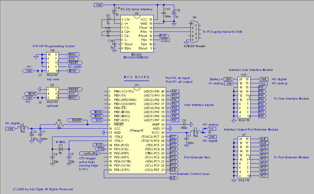

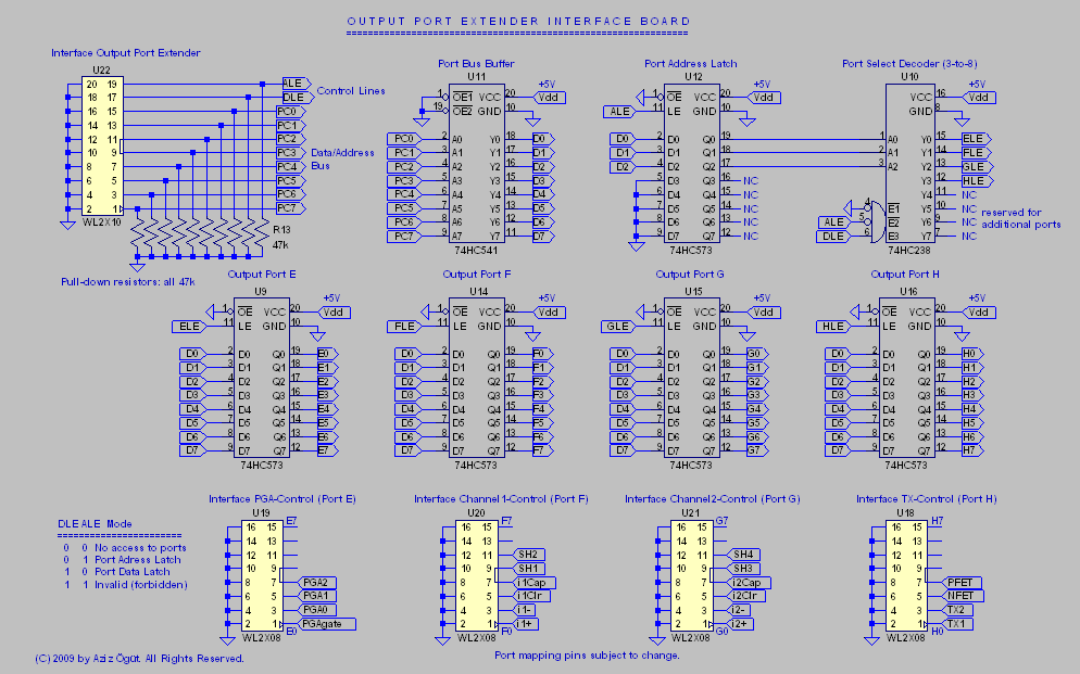

          • Hello friends,
            I want to start with the following simple MCU design, which allows me more I/O lines for experimenting and extending. As you can see, I am supporting only the RS-232 interface at the moment. The USB implementation is also very easy using the FD232R chip but the darn chip isn't available in PDIP pinout and it is quite difficult to solder it (flysh1t small).
            The port extender is implemented as all output ports and will be controlled by the software. Some of the unused pins of the MCU could still be used as input lines.
            I have not tested this design yet and will start to solder it soon. If you find a bug, then let me know.
            Aziz
            • MCU board finished.
              Hello friends,
              the new MCU board is finished and is running.
              I had to modify the circuit slightly:
              The MAX232 chip is causing high frequency spikes on the +5V digital power supply. This is normal due to implemented DC/DC converter running at >100 kHz. So the MAX232 chip must be supplied at the choke (L2) output. Add additional bypass electrolytic capacitors to C2 (100 µF at least) and C12 (10 µF at least). The choke itself should be increased in inductivity to reduce more noise.
              Now the MCU caused noise levels on I/O pins:
              High output level: 80 mVpp
              Low output level: 40 mVpp
              Analog multiplexing I/O lines should therefore be decoupled with bus-buffers or similar solutions. The noise is a high frequency noise (CPU frequency 16 MHz) and is easily inductive/capacitive coupled to sensitive analog parts. So never use them directly from the MCU.
              I probably will power up the port extender with much cleaner +5V analog supply. I will add more chokes to my modules next time.
              Aziz
              • Port Extender Finished.
                Hi all,
                I just have finished the port extender module. It is running so far. I currently didn't have the 74HC238 DIL chip at home so I have selected via hard-wired just the PORTE active and the others inactive.
                Now the I/O port lines have much less noise on it: 3-4 mVpp noise regardless of its state (logic 0/1). It even can be improved further, if the power supply of the port extender is removed from power supply noise.
                I did forget to mention, that all 74HCxxx chips in the port extender module should have each 100nF bypass cap on its supply pins. The schematics is not showing this yet.
                The power startup default output of the external ports is 0 (all output ports logic 0).
                I have a 74HC238 SMD version and will think of modifying it to a DIL version.
                Never control sensitive analog units with direct MCU I/O pins!
                Aziz
                • Hi all,
                  here is some comment on how to access the external ports (port E, F, G, H):
                  ALE and DLE bits should be initialised to logic 0 at start-up time. Then all external ports should be initialised to their default values using the general port access procedure below:
                  General port access procedure:
                  DLE = logic 0 (disable data latch)
                  PORTC= external port address (0=port E, 1=port F, 2=port G, 3=port H, ..)
                  ALE = logic 1 (make address latch enable)
                  ALE = logic 0 (external port adress now latched=stored)
                  PORTC= port data (write data to port)
                  DLE = logic 1 (make external selected port transparent)
                  Now all PORTC accesses will be visible and transparent to the selected external port (DLE=1). A small latency time is there due to typical propagation delays of the chips (74HC541: 9 ns, 74HC573: 14 ns, total: 23 ns). Reading of PORTC is only valid to a selected external port and does not support reading other external ports (all output). So the application needs to know, what is stored in the external ports. External port changes require a full initial write to the selected port.
                  The ALE and DLE bits can be set and cleared using the bit set or bit clear commands. The time overhead for port changes is not critical as we have lots of wait timings. So the wait timings could be reduced due to port change overhead.
                  Aziz
                  • RS-232 interface is working.
                    Hi all,
                    the RS-232 interface seems to work (transmit & receive). I did not decide the final baud rate yet. It depends on the communication processing mode. The MCU has only one character receive buffer and the data must be taken out as soon as possible until next data is received. Some time-critical commands won't permit nested interrupts or will block the main program flow for some period and if the received character isn't read out in time, it will be lost. A FIFO buffer would be good - but there isn't any.
                    Only the receive path to the MCU is critical (laptop side has FIFO buffer chip). But there are several ways of handling the communication:
                    - high speed communication with error detection and repetition flow control (at 115.2 kBaud)
                    - low speed (9600 Baud, low communication overhead, max. one character per transmit pulse rate)
                    - switching between communication mode and processing mode
                    Anyway, the communication is not critical. I will see, which option will work well.
                    I probably will support several compatible 40 PDIP AVR MCU variants:
                    ATmega16-16PU, 16 MHz (I have samples)
                    ATmega32-16PU, 16 MHz (I have samples)
                    ATmega164P-20PU, 20 MHz (improved ATmega16)
                    ATmega324P-20PU, 20 MHz (improved ATmega32)
                    ATmega644P-20PU, 20 MHz (I have samples)
                    ATmega1284P-20PU, 20 MHz (no source found yet)
                    Only minor firmware changes are required to support different MCU's. But it gives second source as well as discontinued MCU flexibility options.
                    I will give a go to the ATmega644P-20PU chip at 20 MHz first. The internal 4 kB SRAM should be by far big enough for complex PI firmware coding.
                    I will order the missing 74HC238 chip today and will test the port extender soon, whether it is working or not.
                    Aziz

                      • Hi all,
                        see below the external port change CPU op-code implementation:
                        syntax: PCH <addr8> <data8> (3 byte op-code)
                        Code:
                        //-------- External Port Definitions  ---------
                        #define    EXTPORT_CTRL  PORTD
                        #define    EXTPORT_ALE   6 // pin #20/PD6/ICP1
                        #define    EXTPORT_DLE   7 // pin #21/PD7/OC2
                        #define    EXTPORT_PORT  PORTC
                        // Op-code implementations
                        //CMD_PCH: Change external port and write data
                        // syntax: PCH <addr8> <data8>
                        // addr8: Port Address (byte: 0=PORTE, 1=PORTF, 2=PORTG, 3=PORTH, ..)
                        // data8: Port Data (byte: 0-255)
                        ; clocks: 6+14 = 20 (16 MHz: 1250 ns, 20 MHz: 1000 ns)
                        Cmd_PCH:
                             ld    PI_Param1, PI_PC+         ; (2) Get External Port Address
                             ld    PI_Param2, PI_PC+         ; (2) Get External Port Data
                             ; Port Address Access
                             cbi   EXTPORT_CTRL, EXTPORT_DLE ; (2) Disable Data Transparent-Latch
                             out   EXTPORT_PORT, PI_Param1   ; (1) Write External Port Address
                             sbi   EXTPORT_CTRL, EXTPORT_ALE ; (2) Enable External Port Address Latch
                             cbi   EXTPORT_CTRL, EXTPORT_ALE ; (2) Latch External Port Address
                             ; Port Data Access
                             out   EXTPORT_PORT, PI_Param2   ; (1) Write External Port Data
                             sbi   EXTPORT_CTRL, EXTPORT_DLE ; (2) Enable Data Transparent-Latch
                             CMD_PREFETCH                    ; (4) Macro: Prefetch next op-code and decode
                        The code above makes secure access to the external ports possible. The op-code execution time of PCH is 1µs at 20 MHz. Once the external port is selected, other port access op-codes (write, bit-manipulating) will run faster. The long lasting execution time is really not critical.
                        Aziz
