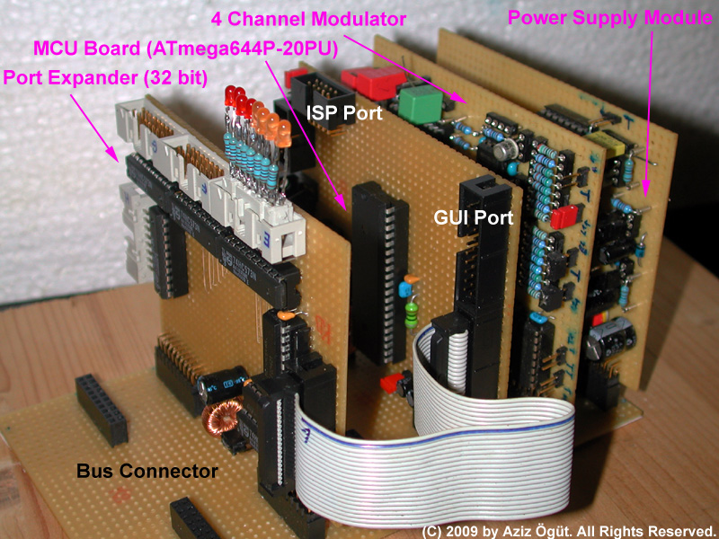

          Hi all,
          below is the current work of my slow going project. Four boards now finished and the port expander is working as specified and desired (the 74HC238 did arrive today). I did test the port expander with LED's and a test code (seems to work). Final test with scope should be done later.
          I have to develop now the following parts yet:
          - Coil driver + pre-amp
          - PGA (+VCA)
          - Integrators (two)
          - General user interface module (switches, pot's, ..)
          - Software
          There is still huge work in the software part to do. Anyway, I am again total bankrupt and have to wait until next month. I have another bunch of parts to order yet. Fortunatelly, the software part does not cost me anything and will fill the gap in the mean time.
          Aziz

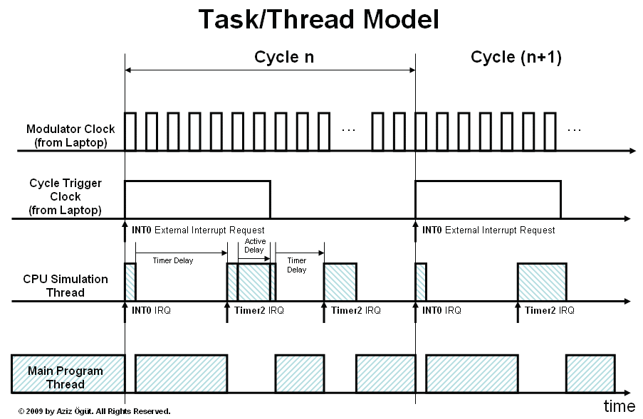

                    • Threading Model
                      Hi all,
                      below is the basic threading model of my PI controller platform. It shows roughly the interaction between the CPU simulation (CPU code = controller code) and MCU execution mode (AVR microcontroller code).
                      There is a strict seperation of program codes and the MCU (AVR microcontroller) won't store any CPU code in the flash memory. So it comes with controller code free and should not infringe any existing patents. The user is responsible to meet international patent laws by providing a convenient CPU code, which does not infringe patented methods. The CPU code will be downloaded from the laptop.
                      The threading model shows also the difference between active delay and timer delay. Active delay won't release the MCU and it stays in the CPU simulation mode. This makes accurate short timings possible. On the other hand, timer delay will release the MCU and switch to the main thread. This will give much processing power for other controller tasks (communication, user interface, .. ) .
                      The main thread won't know, what the CPU simulation thread is really doing. So it could run either asynchronously or synchronously to the cycle time (with synchronisation status flags or instructions).
                      I very likely will use Timer0 as an internal timebase for the main thread to signal some states or tasks. To meet accurate timings with less timing jitter, I only will use INT0 and Timer2 interrupts (see below). No other interrupts sources will be used.
                      The communication part will be the biggest part of the firmware code, on which I will work much longer. It will support upto 256 commands and will be an ASCII based communication protocol. So any ASCII terminal software could be used to test some parts of the hardware. The decoding and processing of the commands will also be very efficient.
                      Aziz
                      • Hi all,
                        some more notes on the threading model above:
                        It is obvious, that the cpu simulation thread is being triggered by the external cycle clock coming from the laptop (sound card). The controller instructions were decoded and executed in their presense in the controller program memory (stored in the SRAM). Timer delay will release the MCU for the time period defined by the timer delay instruction parameters (prescaler, count). After the timer is expired, the CPU simulation continues with the next instruction (Timer2 IRQ triggered). At the end of a cycle period, a particular controller instruction signals the end of the cycle and will relase the MCU to continue in the main MCU thread.
                        A multi-cycle controller program code can also be implemented easily by coding multiple cycles program (each cyles will have its own program code).
                        I have to implement a special controller assembler program to generate the controller program object code. Depending on the mode of operation, there can be several controller program codes, which will be downloaded on the demand (user interface action). Each operation mode will have its own controller program code of course.

                        • Some changes necessary.
                          Hello friends,
                          during implementing an internal time base for several internal tasks (using Timer0), I have found some conflicting issues.
                          Timer0 is coupled to Timer1 when initiating a synchronisation (timer 01 prescaler reset). Timer1 is reserved for two PWM outputs (A and B) to make a synchronized DAC output to cycle periods. The DAC output could be well used in a VCA (voltage controlled amplifier). But it has to be fully synchronized to cycle period. This is a must have criteria.
                          So it would be more convenient, to change the former Timer2 operation into Timer0. The PWM on Timer1 can then only be operated on /1 (no prescaling) as the timer delay instruction has to reset the prescaler. So the PWM frequency can be set from 305 Hz into hundreds of kHz (16 bit timer).
                          The internal time base could then run on Timer2 instead and won't disturb the PWM outputs. I have defined a 10 ms timer interval (using prescaler /1024) for the time base and it should allow an efficient operation resolution.
                          The internal time base is used for:
                          - checking battery on x sec intervals
                          - checking user interface on intervals (pots, knobs, push-buttons, debouncing of it)
                          - communication (timeouts, live, status messages, ...)
                          - status lights (LED's blinking)
                          I will look further, whether this change causes other problems. But it shouldn't be a real problem at all.
                          Aziz
