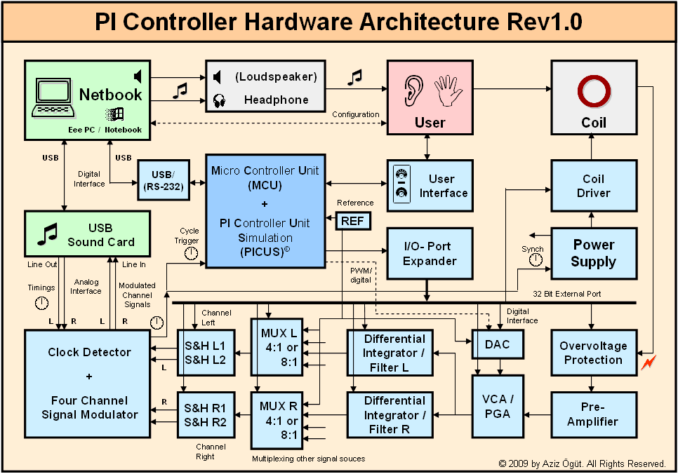

            • PI Controller Hardware Architecture Rev 1.0
              Hi all,
              below is the hardware architecture of the current project. It should be a good base to start with. Even if I should not able to finish this project due to some unforeseen circumstances*, but some of you could still follow it. Some parts of the design are not finished yet and might change slightly.
              Aziz

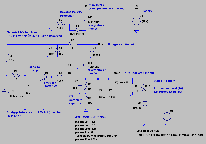

                      • LDO Regulator for Eee PC 901
                        Hi all,
                        the netbook Eee PC 901 needs some power supply circuit for field usage (12V car adapter regulator). You can forget all the cheap ebay devices. They are waste of money.
                        The Eee PC 90x series has an external 12V DC input plug (3 Ampere). The specification for this input is tight and the Eee PC detects undervoltage/overvoltage and it switches off in case of out of specification range.
                        I thought, it would be very convenient, to have a power supply module with regulated 12 V output for the netbook. It is ok, if the design is optimized for 12V operation and a low drop-out (LDO) regulator could feed the netbook. So a pure single supply for the controller and netbook could be realized. The PI controller will support more voltage (up to 18V) and the drop voltage (18V-12V = 6V) for the netbook would be wasted of course. The energy loss would be less, if 12V/13V input is used.
                        I have designed a discrete LDO circuit below, which has only max. 150 mV drop voltage and it would deliver enough high current for the Eee PC. It makes sense, that the PI controller should have a 12 V output for the Eee PC. The car adapter could be fed into the PI controller to charge the Eee PC's battery.
                        In the field, only one big single battery could be used for both devices (four cell 14.4V Li-Ion for instance).
                        Below is a proposal of the LDO regulator. I have not built it yet and please wait, until it works and I power my Eee PC with it.
                        Aziz
                        • Hi all,
                          ok, the 12V netbook regulation will be efficient now even the input voltage is much higher than 12V. Only a fixed drop of 0.5-1V will be heated up from the high battery voltage.
                          Could be a new invention. I should check this some time.
                          Aziz
