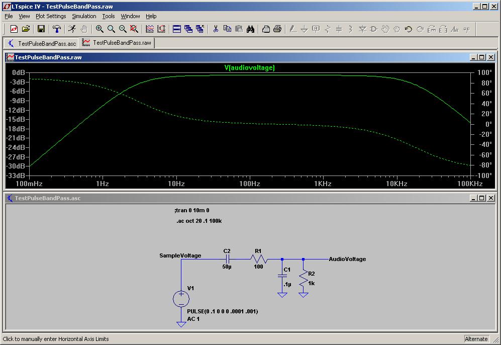

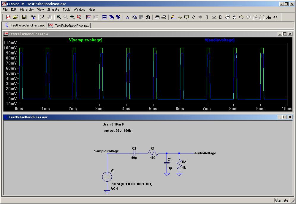

                                Hi Aziz:
                                Direct sampling is exactly what I'm saying! You have arrived at same conclusion. My feeling is the original RX pulse dv/dt is sufficient to pass through bandpass filter of audio card. Yes, there will be some distortion, but predictable. You should have enough information to use as metal detector.
                                As an example, I attach spice simulation of feeding pulses into a bandpass filter, approximately same band as audio card. The pulses could be the time multiplexed S&H voltages referred to before. You can see that the pulses are modified a little, and there is a drifting bias that will settle eventually, but otherwise if you measure pulse height, it should be very representative of the input pulse, scaled somewhat.
                                If your audio card can actually get enough samples from the original pulse, then yes, feed that straight in! As for integrating it before sending to audio card -- that sounds like you would have to differentiate later in software, maybe noisy process.
                                I'm just having fun thinking about your project, don't really know anything -- you are making very real and excellent progress -- all experiments and ideas are very interesting to build and test, always something to learn. Thanks again for showing all the progress.
                                Cheers!
                                -SB
