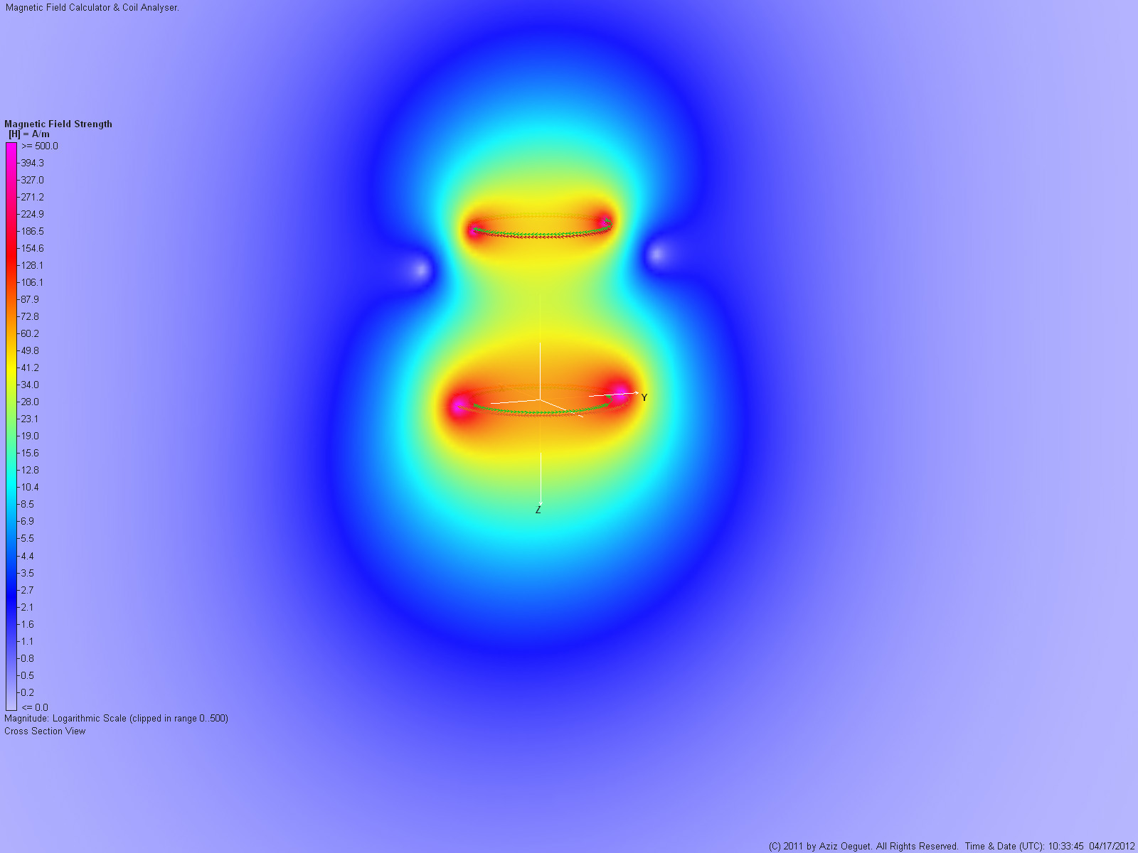

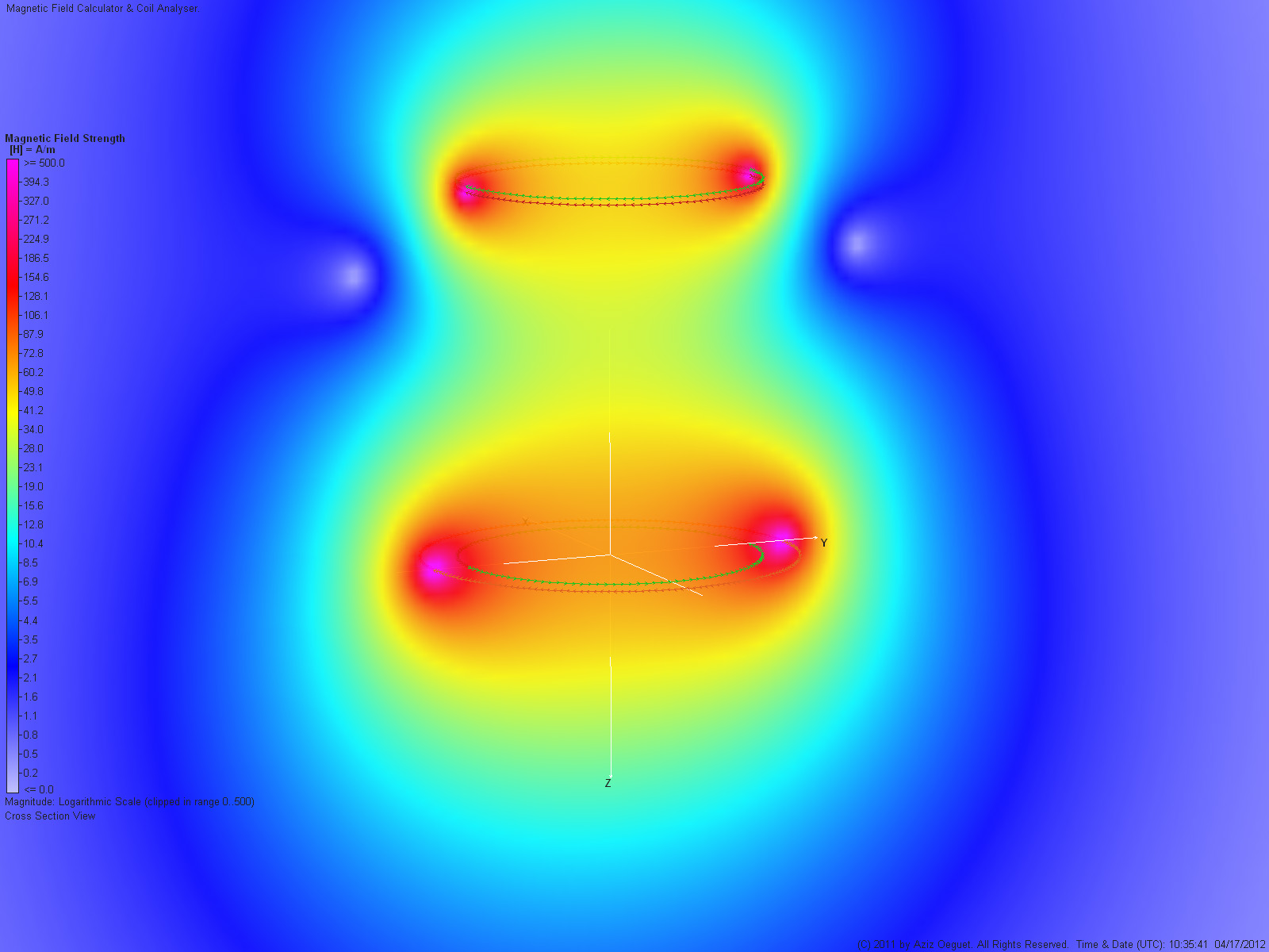

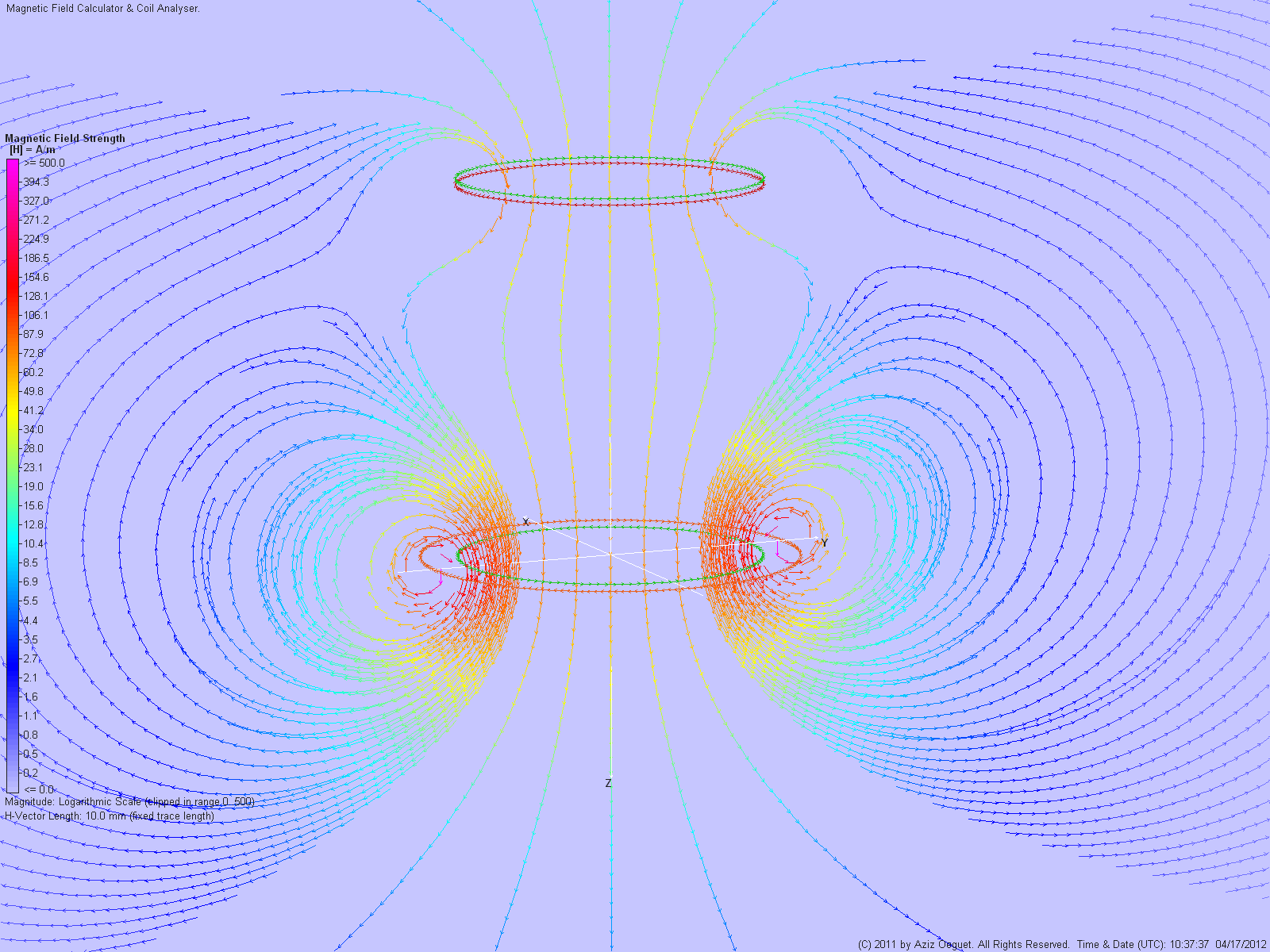

          • Top Hat Coil EM Fields
            This is for your eyes.

                It depends on the magnetic flux of the RX+ coil part. RX+ coil should be as big as possible and should have as low inductive coupling coefficient as possible to the TX coil (0.5R .. 0.8R is reasonble radius range for RX coil, TX = 1R).
                The induced magnetic flux of the RX+ coil must be compensated with the induced flux of the RX- coil. So the RX- coil should have as much inductive coupling coefficient as possible to the TX-Bucking coil. TX-Bucking coil doesn't need much turns count. The distance depends on the coupling coefficient.
                To avoid a significant target response cancellation, the distance of RX+ and RX- coil should be as much as possible.
                More turns count for the TX coil, less turns count for the TX-Bucking coil.
                These are the basic principles.

                  Rx coils in antiphase - this one cancels earth field and far field emissions. Did you check how close you may place them to retain this behaviour?
                  The closer the better for that behavior (cancellation)! But not for detecting targets... the farther the better for that. That is the tradeoff.
                  That's how it looks to me anyway.
                  Of course the main "con" to this idea is the cumbersome coil -- extra wire that doesn't participate in detection, only cancellation, adds weight, not to mention the bulky shape.
                  You can also theoretically do a "visor hat" balanced IB design that wouldn't need the bucking coils at all (which is what I was envisioning for my experiments). It would look even weirder and may be harder to physically balance on the shaft.
