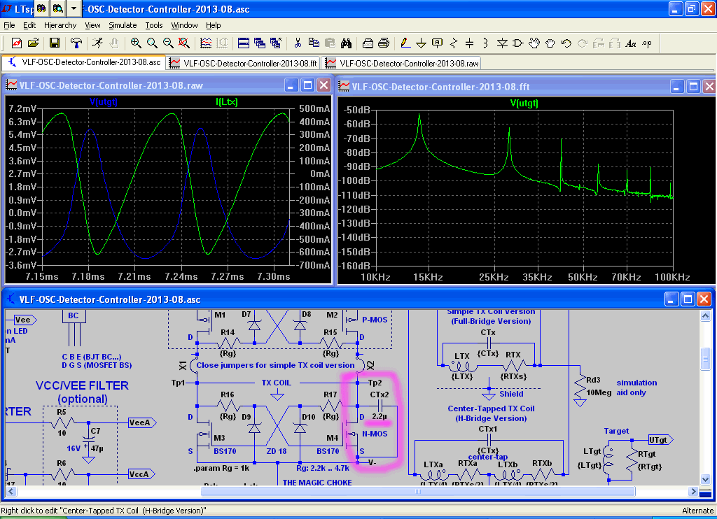

    • Magic Multi-frequency OSC Variation
      Hi all,
      I want to show you what happens, if you connect a second resonant capacitor (CTx2) to Tp2 (or Tp1) and V- connection. See the coil current wave form below. Do you see a basic similarity to the TEM 2.0/Class-E TEM coil current? Ok, it hasn't enough radiant sine waves but a 0.5 sine radiant at low frequency and 0.5 sine radiant wave at high frequency.
      If you look at the FFT spectrum of the received signal (Rx), you get a nice multi-frequency response (not equialized however). You can do a two or three frequency demodulation with ease. And this is really enough to make a really good ground balance.
      Add this capacitor and you have a multi-frequency oscillator (a mini TEM2.0 *LOL*). The power consumption rises however. That was the magic missing link.

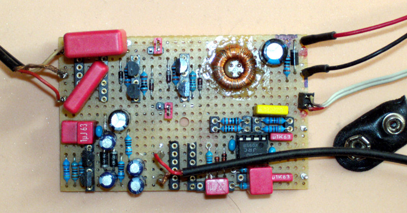

      • Minor Changes to the Latest VLF OSC Detector Controller.
        Hi all,
        I have built the latest VLF OSC Detector Controller (I am referring to the schematics in post #1627).
        (Link: http://www.geotech1.com/forums/showt...202#post165202 )
        It works fine with NE5532. When I am using the lower noise NJM2068, the TX reference voltage attenuator circuit is oscillating at higher frequencies (due to switching transitions of the fets and fast NJM2068 ). To tame this behaviour, add a capacitor to the feedback of the TX reference voltage attenuator (capacitor parallel to R11). Start with 47 pF and increase it, until the high oscillation gets damped (low-pass filtered). But no more than 220pF (enough).
        I even have reduced the resistors value R11, R13 from 10k to 4.7k to use the magic modification (multi-frequency option) so the TX reference voltage gets attenuated more.
        BTW, the magic option works very fine.

        • I have built the latest VLF OSC Detector Controller (I am referring to the schematics in post #1627).
          Aziz, Do you have any pictures?
          Jeff
          • Originally posted by jheissjr View Post
            Jeff
            Hi Jeff,
            unfortunately, I have screwed my good old digital camera some time ago .
            Fortunately, I had the cam of my girlfriend handy to make a picture of the latest VLF OSC Detector Controller board this morning (the 3rd prototype).
            But haven't put it into a case yet.
            Cheers,
            Aziz
