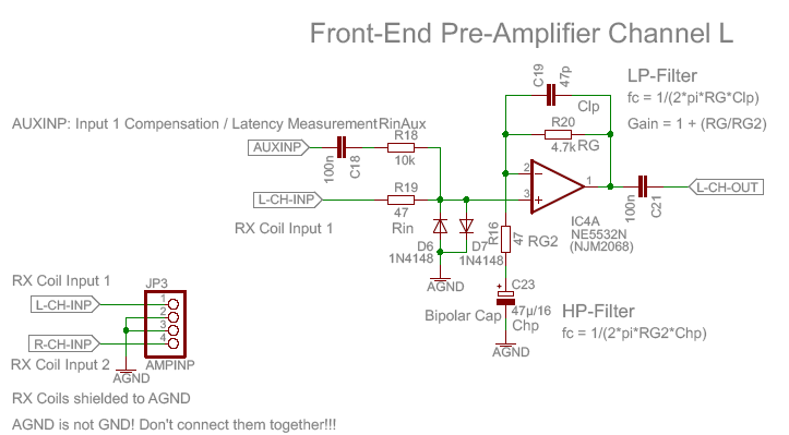

          Below is the standard non-inverting AC amplifier configuration, which works very well. Notice, that the DC blocking capacitor C23 should be a bipolar AL-electrolytic capacitor, which should withstand reverse voltages of up to at least +/-1.5V. Well, the poor man's solution is to use the standard AL-electrolytic capacitor, which works in the high voltage clampling circuit only (reverse voltage limitted to +/-0.7V and the AL-electrolytic caps can do with +/-1.5V reverse voltage).
          Attention! Don't use Tantal types, they don't withstand even small amount of reverse voltage. Well, the PCB space is limitted and I have to put the small AL-electrolytic caps.
          But we should know, that the reverse voltage causes a faster aging of the AL-electrolytic capacitor. We could also use the high capacitance MKS-2 caps (1 .. 2.2 µF) but we have to increase the RG2 to achieve the low cut-off frequency fc of the high-pass filter. In the example below fc is set to 72 Hz.

          • BTW,
            you can test an AL-electrolytic capacitor for the circuit above before you solder it to the circuit. Just use a battery cell (1.2 or 1.5 V) and connect the capacitor in reverse polarity. Measure the current flow. It must not exceed a few µA.
            I have put a test capacitor yesterday and the current flow is less than 1 µA. And it's still alive.

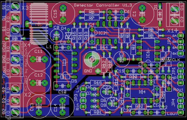

            • Preliminary PCB Layout of Version 1.3
              And this is the current PCB layout. But it is not finished and needs some changes as well.

                You could also use 2 capacitors "back to back". The voltage needs to be double.
                  Tinkerer
                  Yep, also a good idea.
                  But the standard Al-electrolytic capacitor in the circuit isn't critical at all. We can take the cheap and small Al-electrolytic capacitors, which will fit well into the new PCB.
                  At high frequency EMI induction, there won't be high reverse voltage (only offset error voltage of the op-amp). Other detectors EMI induction isn't critical therefore. It's only critical below the cut-off frequency fc of the high-pass filter.
                  Well, in the 12 V battery configuration (+/-6 V supply), I measure with very low frequency EMI (10 .. 100 Hz) only +/-0.2V at the capacitor (that's max. peak only). This isn't critical.
                  At normal operation, the low frequency isn't there as the detector would operate at much higher frequency.
                  Cheers,
                  Aziz
                  PS: The PCB layout is optimized further... wait until I publish the final version. Be patient please.

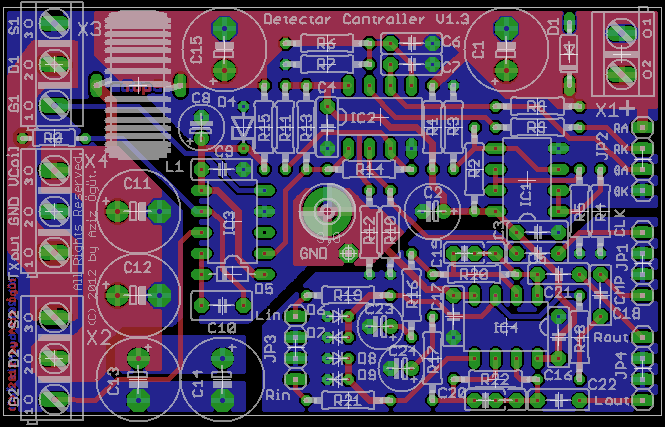

                  • *** Latest PCB-Layout, Schematics and Eagle Files ***
                    Hi all,
                    this is a hot candidate for PCB fabrication. I hope, I didn't make any bugs.

                    PS: This is detector controller version 1.3
                    • PCB V1.3
                      Damn it! The labels Rout and Lout must be exchanged of course!
                      Ok, I have to look better next time.
                      Aziz
