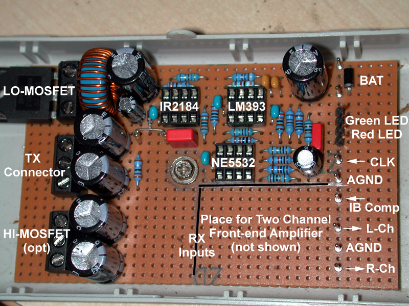

                    • First Parts Placement
                      you see the first (loose and not soldered) parts placement below. I have tried many different configurations but this seems to be more convenient. Unfortunately, I'm limitted to the plastic case. The evil screw in the middle drove me mad.
                      The big buffer caps makes a good shielding wall to the sensitive electronics area in case of the high voltage TEM TX mode. In the H-Bridge mode, the coil connector voltage isn't high.
                      I had to take a picture of the placement. You never know, if you drop the loose placement, you don't remember how it was before.
                      I like this little circuit, because its so ridiculous simple but it is working very well. And you won't find a voltage regulator there. Back to the roots and to the K.I.S.S.-principle.
                      In the couple of coming days, I'll solder and test it.
                      Cheers for now,
                      Aziz
                      PS: I'll publish the schematics and circuit spice files later!!!

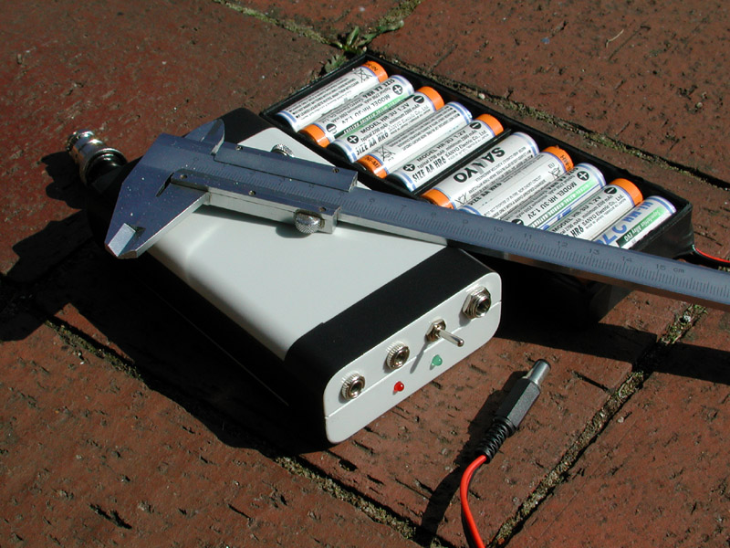

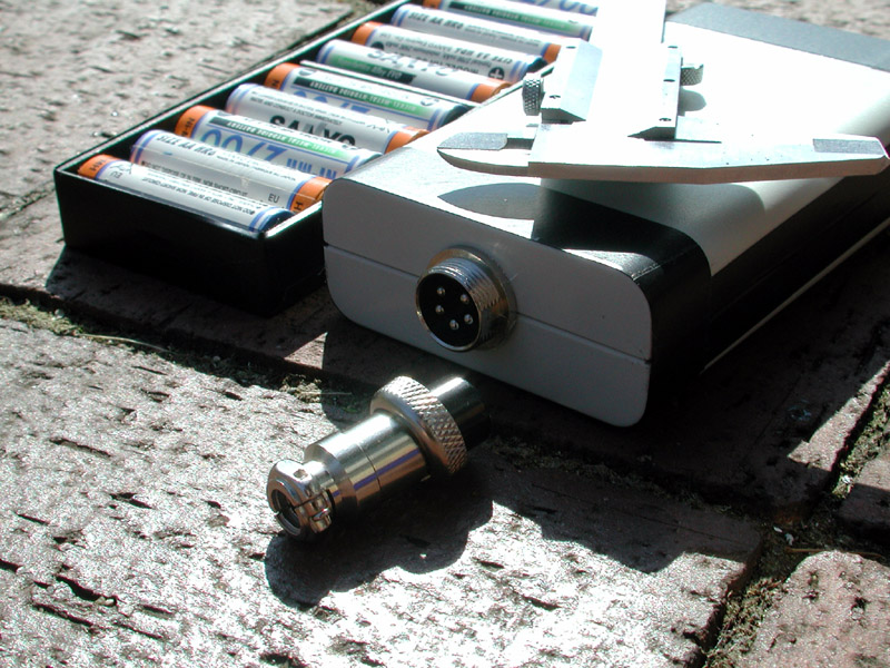

                              • Detector Controller Finished
                                Hi all,
                                I have finished the simple & smart (true digital) metal detector controller (no name yet). Fully functional but not connected to the coil yet.
                                Coil? Oh yes, I have to make some more coils.
                                (Was it the #127 or #128? )
                                Cheers,
