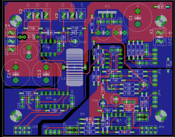

    I find, that individual shaped signal planes (polygons) direct the auto router much better instead of using obstacles. Pity, manual routed signals are lost if you type the "ripup;" command. One need something like "lock" feature. The ripup command can exclude signals from beeing ripped. The polygons are still there after ripup command however.
    All the ground planes and high current routing path are made with signal polygons therefore.
    Well, the auto router is very dump and creates often obscure routing result. It causes a lot of work for fine tuning (cosmetics).
    The reason, why I use the auto route script is, that the DRC rules apply always. Otherwise, it won't route the signals (as Mr. Q mentioned).

    • Hi all,
      this is what I get when I run auto route script. Only minor cosmetics required. No via's (I think). It's not bad finally.

        Sure is pretty. What layers are we looking at? Is there a list that would show the vias?

          Red=Top, Blue=Bottom. The PCB isn't finished for production however.

          Vias = 0!

            But wired this under choke may prove as very poor solution:

              Thanks WM6,
              a good point indeed. I'll try a different layout.

                there is a much much better PCB layout possible. I'll rip(up) the current PCB and make this little beast completely new. It was a good decision to wait with the bread board wiring. Nevertheless, it's difficult to control the auto router. But it delivers good information about the parts placement.
