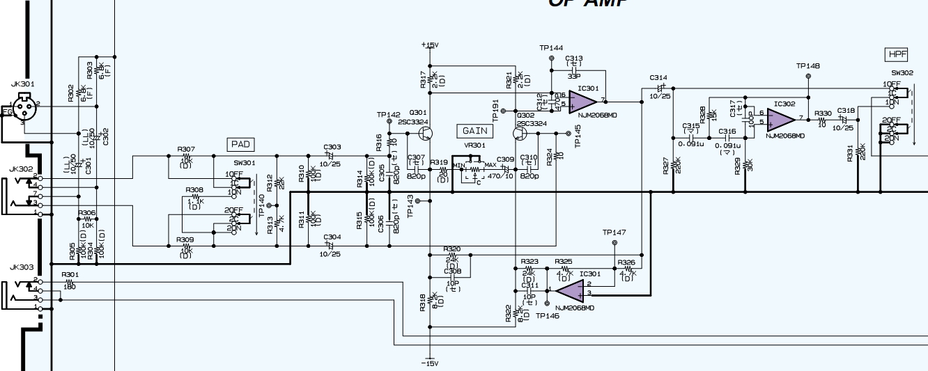

      • hi aziz
        good choice NJM2068 YAMAHA EMX5000 powered mxer (2x500w)used it in the mic. input channell

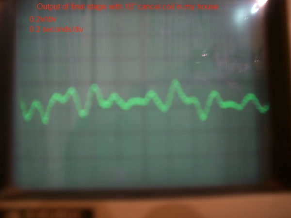

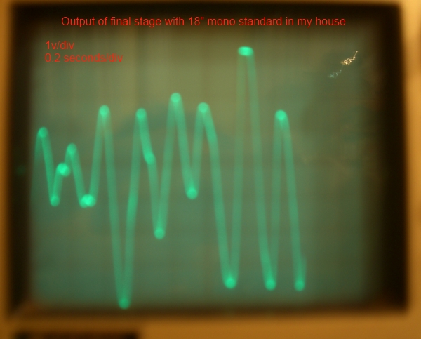

                Been fiddling again, firstly figured out why I was not getting good results last week, solder bridge in the middle layer of my front end board effectively shorting out my receive coil! Found this out the hard way when I went to hook up a mono coil out bush and she didn't want to work! The tx fets just about de-soldered themselves
                Anyway, back in business I have an 18" "mono" coil running with a 18" rx coil. The null is adjusted by adjusting the gain on the preamps then the 2 signals added into one. I have set the -rx coil about 1" above the tx(rx+) and I am happy to say that it seems to detect targets quite well. The preamp gains can be tweaked a little to give one coil more bias otherwise a target can just about be cancelled out. Anyway I can now have my detector running inside the house and it is relatively smooth, especially compared to just a normal 18"mono. I am running with a maximum gain of 91 on the preamp and the next stage has a gain of 3. I can now turn the coil on its side and not get a barrage of warbling. Time to wind up a similar setup for my 25" I think! I know that this is not IB, this is just plain old noise cancelled mono, but at this point in time this is what I need.
                Check out the piccys of the output of the last stage of filtering just before the audio section. Both taken with full front end gain, first just a standard mono @1V/div 0.2 seconds/div and the second is the emi cancelled mono, @ 0.2V/div 0.2 seconds/div
                No more pesky electric fences for me
                Cheers Mick

                  • Hi Aziz,
                    I realize that more distance would be better, but, with a deep target a lot of the time you lift the coil 1" and it is just about gone. If more receive bias is put on the closest coil to the target this difference will be a bit greater again whilst still keeping emi levels way down compared to the conventional method. But yes I will try adding more distance to see the full effect. Test pit here I come.....
                    Also emi levels out bush are never as high(no where near it) as what they are here at home. A really bad day may be comparable to the noise canceled waveform at my house, so I can afford to not have the 2 coils %100 cancelled.
                    Cheer Mick
