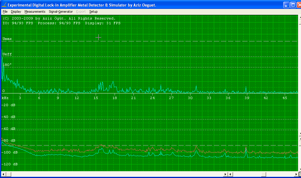

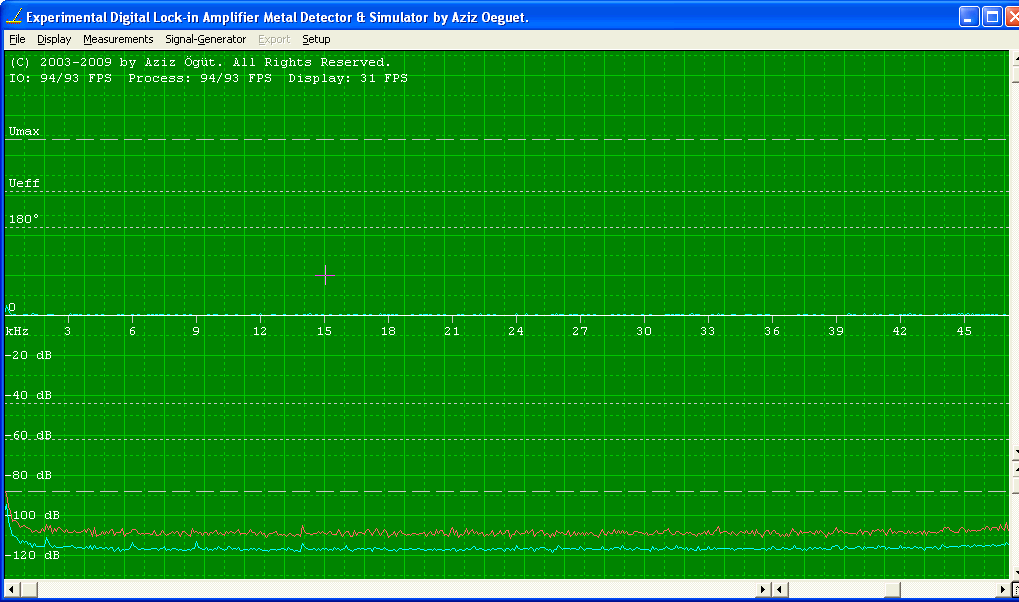

                        Hi Mick,
                        the noise floor level is the white noise spectrum density level for a 1024-point FFT at 96 kHz sampling rate (93.75 Hz bin size). We have a higher 1/f noise at low frequencies of course (I didn't take the 1/f noise into account above).
                        See below the noise floor level for a shorted input LT1028 in above described configuration. The second picture below is the same with RX coil connected to it.
                        Yes, LT1028 works indeed very fine. We can use a poor man's low noise design as well with the hand matched BC337-40 transistor pairs and a NE5532 (or the low noise types above). But this would require more parts (there isn't enough PCB space).
                        Yes, large coils do have big problems with EMI noise. That's the reason, why the "top hat" coil will live long.

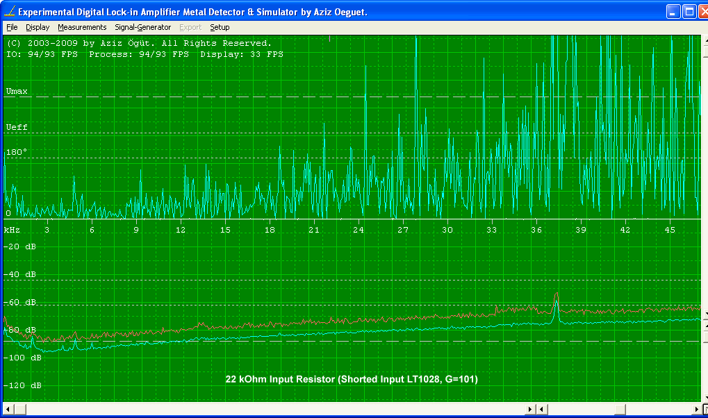

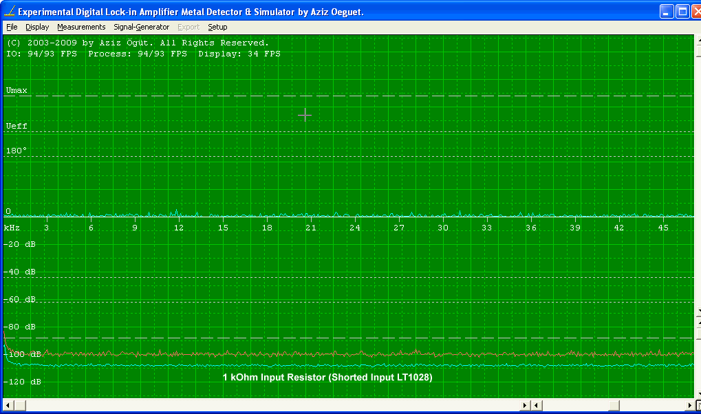

                            Yep, the coil measurements were done at home (high EMI environment).
                            Ok, below is the 1 kOhm and 22 kOhm input resistor at G=101 (input shorted). Note, that the 22k variant is quite noisy and instable (a real eye opener).
                            Cheers,
                            Aziz
