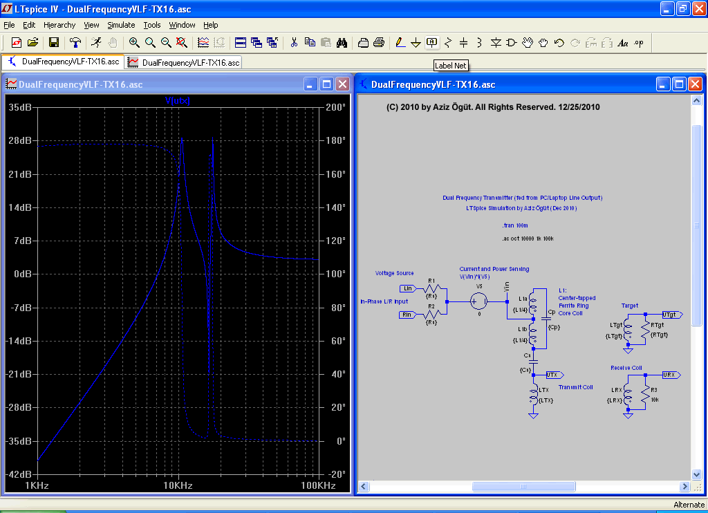

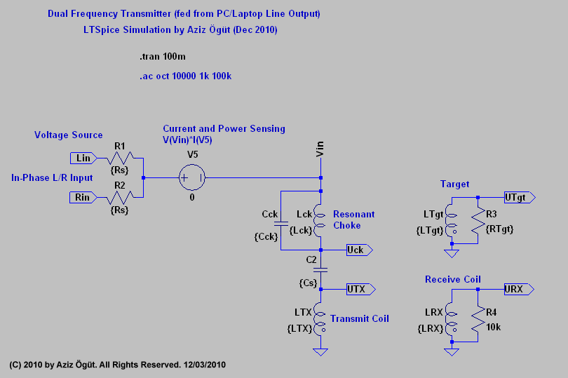

    Hi Aziz
    what is basic circuit idea behind this? I am not sure if I am understad functionality of this frequency response diagram mapped to real world of circuit.
    Hi WM6,
    the circuit is a simple filter with two resonant frequencies (current will be passed, voltage will be amplified). The search coil (TX coil) is part of the filter network.
    It's a very simple implementation. See below the circuit principle. The capacitor Cs and Inductor LTX is the series resonant tank (for the higher frequency f2). The capacitor Cck and choke Lck is the parallel resonant tank (dominating the frequency f1). The LRX is the receive coil as an induction balanced configuration. I have put both stereo output signals from the sound card to lower the signal source impedance (from 30 Ohm -> approx. 15 Ohm). The Resistors Rs (R1 & R2) are typically very low (1 Ohm). But a single voltage source is also possible.

        • Hi all,
          I have to make a small correction regarding the latest posts:
          The term choke is only valid, if there is flowing a DC current through the coil. But we haven't a DC current in the coil. So it's becoming only a coil (with or without magnetic core).
          Ok, at the end, the good solution becomes only a band-pass filter with overshooting pass characteristics at the corner frequencies f1 and f2. To achieve the overshoot characteristics, we need high-Q factor parts (see http://en.wikipedia.org/wiki/Q_factor)
          We could also implement the same filter in the receive part. This would be very nice to suppress a lot of EMI noise. Band-pass filter is more convenient to implement a multi-frequency analysis, which could be done very easy (via chirp wave form).
          I have a new implementation of the filter, which should be much better than the previous one (see below).

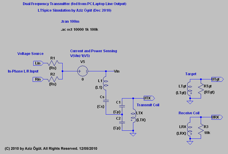

                        • Another Dual Frequency Transmitter Proposal
                          Hi all,
                          look at this dual frequency transmitter example. It is optimized for two frequencies only and achieves better efficiency. It can produce really high voltages (>100 V), if your voltage source can deliver enough power (small power amp, low source impedance).
                          The two frequencies and their spectrum power content can be dimensioned by the four parts: L1, Cp, Cs and LTX (search coil). Note: L1 is a center-tapped coil wound on a ferrite ring core. All filter parts must be high-Q parts (low losses).
                          This type of transmitter is optimally suited for a DSP starter kit with built-in codec. You need a power amp, a receiver front-end, this filter and a sophisticated DSP software.
                          You can also drive it with digital clock feed (containing the two fundamental frequencies) instead of sine waves. Should give more power to the coil.

                            Hi Aziz
                            what of part is V5 0 (or maybe Vs 0)?
                            Voltage source? What of voltage source is then on left.
                              Hi Aziz
                              V5 is only a voltage source of 0 volt with very low resistance (ideally 0 but LTspice makes a very small value to be able to calculate). It is measuring the current without causing a power loss. It's voltage drop is ideally 0 Volt. You can replace it with a very low resistor (1 mOhm or less) if you like.
                              The voltage source on the left (not shown) is the signal source containing two superimposed sine waves of two different frequencies (f1, f2). I have put the two left and right sound card lines together to lower the output impedance of the output line (more current drive). You can also feed a single line voltage source if you have only one channel (mono channel).

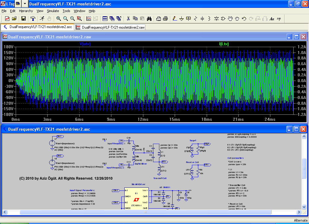

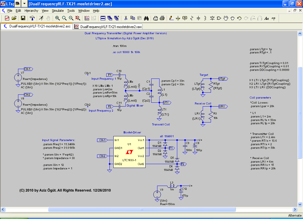

                              • Dual Frequency VLF - High Power Version
                                Hi all,
                                BTW, there are half a dozen other possible configurations possible. Next step is to make the power amplifier simple & efficient. And the two frequencies should be driven with pure digital clocks (makes easy interfacing to µC/DSP).
                                So we need a digital mixer. A simple way is doing it with two resistors. But this solution is not efficient and has power limitation.
                                Well, we can use complex resistors instead. Indeed, a center-tapped coil and two capacitors can be used as a good mixer.
                                Power amplifier? Why not using a mosfet-driver. Simple & cheap.
                                The main filter can be made more simple with two capacitors (Note: L1, LTX no tap). Below is a version for you to play with. Spice file included.
                                Cheers,
