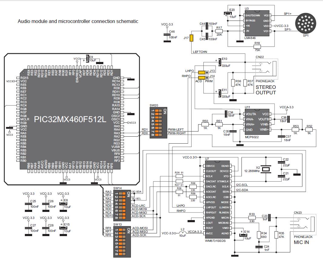

                  • There's an interesting schematic on the libstock website but I think they expect you to connect several pcb's to make it.
                    http://www.libstock.com/projects/vie...wm8731-example
                    It would be nice to have a board with the dsPIC and WM8731 on it for development...

                    • Hi,
                      Another starting point is the schematic/PCB of the codec shield, it has the essential components/wiring (on Page 3): www.mikroe.com/downloads/get/1463/acodec_manual_v100.pdf
                      One thing that is important is to avoid the MIC IN and use the LINE-IN.

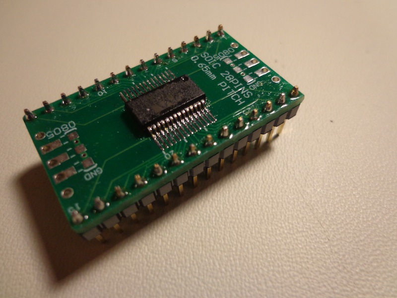

                      I've just DIP-ified the WM8731: Click image for larger version
                      • Funny I just got two of those 28 pin adapters to test some eproms at work and then found out
                        the eproms are 20 pin! So I guess I could use them for a WM chip. Where'd you get the WM?
                        The schematic I was referring to is this one;
                        I noticed the Mikroe bd uses the Mic input. What's up with that? Of course I'd use the line in's.

                        • I got the WM8731 from Mouser (Part# is 238-WM8731SEDS/V) they sell it for 2.44$ + shipping costs (they're based in the US). Shipping to Europe was a pain, I had to order parts for ~80$ to get "free shipping" and paid another 10$ for customs clearing by FedEx + taxes
