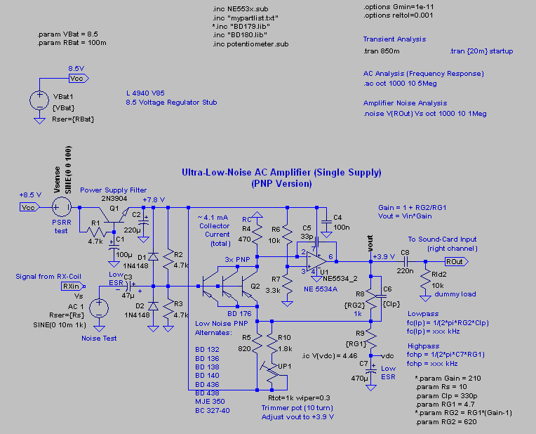

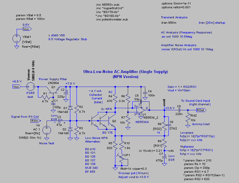

      • Ultra-Low-Noise AC Amplifier
        Hi all,
        look what "blue pills"(tm) have done for me!
        (BTW, it's not Viagra(tm)! )
        This is the NPN and PNP version of the ultra-low-noise AC amplifier. It is fully tested. I'm providing you a fully working LTspice simulation files for your convenience too (see the zip-file below).
        I'm going to use the PNP version for the next detector controller version (Class-E TEM/TEM V2.0). PNP transistors are more quiet. Targetted gain: approx. 100 times, RG2: 620, RG1: 4.7 - 6.2 Ohm.
        Schematics of the NPN-Version:
        Schematics of the PNP-Version:
        LTspice Zip-file:
        Ultra-Low-Noise-AC-Amplifier-4212.zip
        Cheers,
        4212

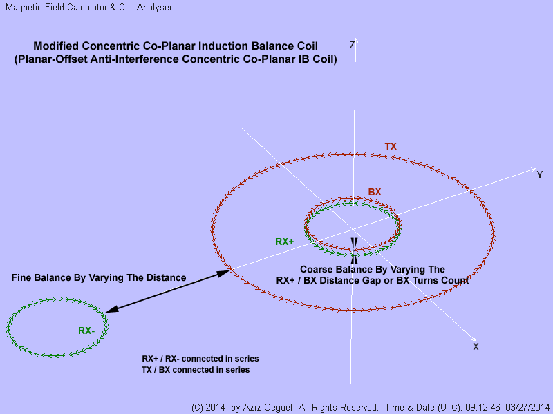

                    • Coil Design 1: Planar-Offset AI IB CC Coil.
                      Hi all,
                      this is a modified standard concentric co-planar IB coil with the anti-interference (AI) and truly fine balance feature. And it is much easier to build this coil compared to a standard concentric co-planar coil.
                      Once the distance gap (mm range) between BX and RX+ and the number of turns count for BX has been found for a specific distance of RX- to the coil, the induction balance can be precisely done (fine induction balance) by varying the distance of RX- to the coil.
                      RX+ and RX- has the same geometry and same turns count (=identical). They will be placed at opposite winding direction to cancel the EMI noise.
                      See picture below:
                      Pay attention to the coil winding directions.
                      Cheers,
                      Aziz

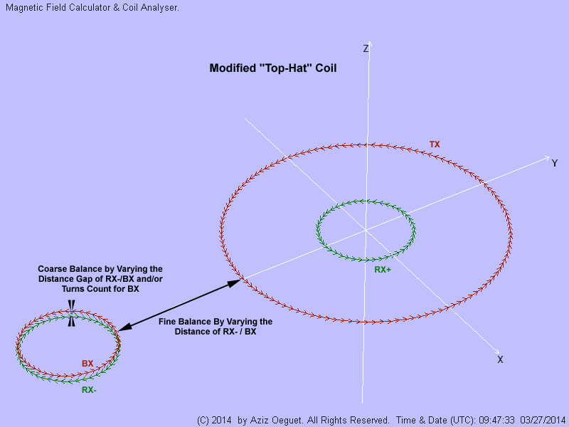

                      • Coil Design 2: Planar-Offset AI IB Modified Top-Hat Coil
                        This is also possible.
                        Pay attention to the winding directions.
                        Cheers,
                        Aziz

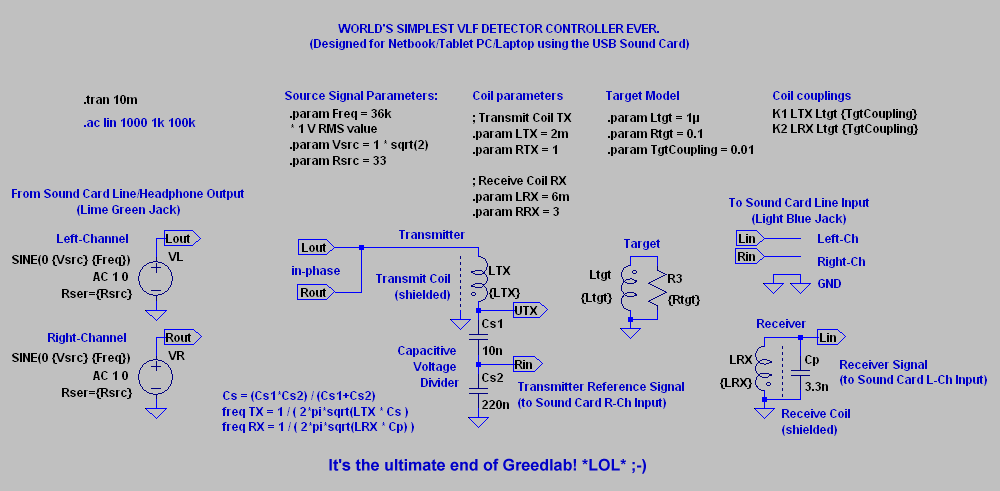

                        • The Ultimate Thermo-Nuclear VLF Metal Detector Controller! *LOL*
                          Hi all,
                          this is for all the guys out there wishing to experiment with pure digital (DSP) VLF detector design (Netbook/Tablet PC/Laptop + Sound Card). It consists of 5 passive parts only and does not need more electronics.
                          You have to process both signal channels however.
                          Hey sled!, you probably could use it for a warm up experience. This little circuit is really nice to start with.
                          Cheers,
                          ^sif
