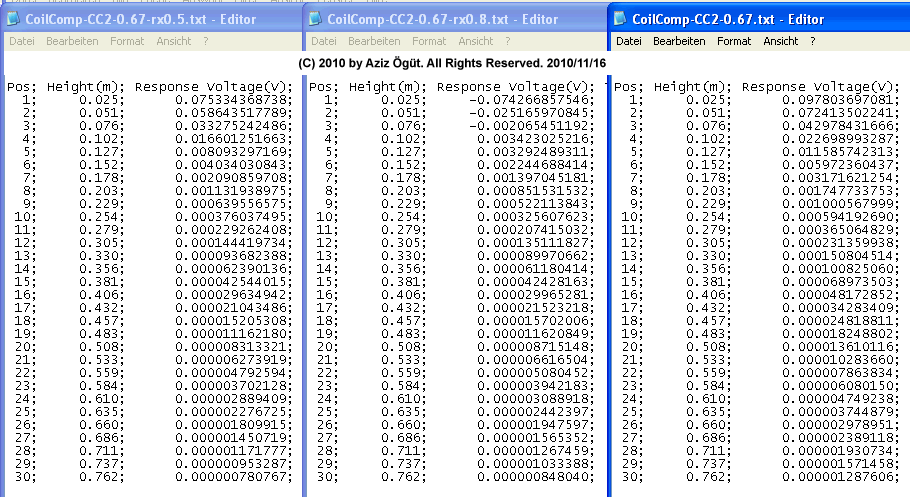

        • Concentric Co-Planar Coil Analysis Part 1
          Hi all,
          this is the first part of the coil analysis, which excludes inefficient coil designs. I have made three coils and can exclude two of them.
          See below the induced target response voltages:
          Left: TX=10" diameter, Bucking= 0.67*10" = 6.7", RX = 0.5*10" = 5", RX coil is smaller
          Middle: TX=10" diameter, Bucking= 6.7", RX = 0.8*10" = 8", RX coil is between TX and bucking coil
          Right: TX=10" diameter, Bucking= 6.7", RX=6.7", RX coil is 4 mm above the bucking coil (same diameter, a typical standard configuration)
          TX coil is placed at z=0 mm, Bucking at z=-2 mm, RX at z=+2 mm.
          As you can see directly, the left and middle design is inefficient. It does not make sense to follow similar configurations with different diameters. If the RX coil is between bucking and TX, the induction balancing gets quite difficult (not practical design). The standard coil configuration (right) is more efficient and practical, as the bucking and RX coil can be wound in the same winding core.
          Cheers,
          Aziz

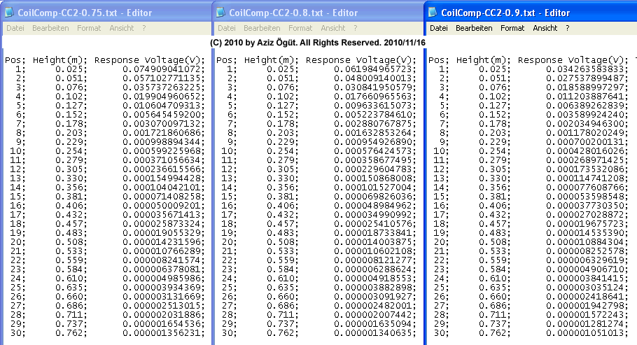

          • Concentric Co-Planar Coil Analysis Part 2
            This is part 2 of the analysis. Now RX and bucking coil will have the same diameter but the diameter itself is varied.
            Look at the tables below. You can see, at which range the diameter gives good depth performance. Smaller diameter Bucking/RX coils tend to give a stronger near detection field (good for pin-pointing) but suffers in the far detection range. Bigger diameter tend to be like a bigger mono coil.
            To the name convention of the tables:
            CoilComp-CC2-0.33.txt means: RX/Bucking diameter = 0.33*10" = 3.3"
            CoilComp-CC2-0.5.txt means: RX/Bucking diameter = 0.5*10" = 5"
            CoilComp-CC2-0.75.txt means: RX/Bucking diameter = 0.75*10" = 7.5"
            and so on...
            Who can see the optimum range of diameter? Now, it should be possible to make a better concentric co-planar IB coil.
            Cheers,
            Aziz
            • Aziz, thanks for the excellent work.
              Let's see if I understand it right.
              With the RX-BU coils at 75% diameter at a distance of 2r, we get about 1.23 times the amplitude of the target response, than at 50% diameter.
              However, we need more turns on the BU coil to obtain balance. More turns on the BU reduces the target response received by the RX coil.
              Where is the sweet spot?
              Tinkerer

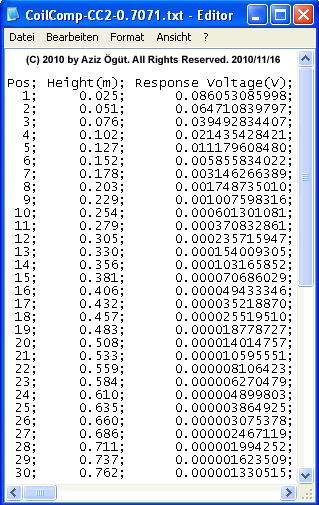

              • Part 3
                Here is the missing diameter variation (see below):
                The sqrt(2)/2 diameter (half of the area of the TX coil)
                Tinkerer,
                it depends on your demands. If you want a deep going coil, look at the tables. This can be seen directly.
                To get the mono coil performance, just increase the RX winding turns (but higher EMI picking). Doubling it, will double the target response voltage. But will make 4 times higher RX coil inductivity.
                Note, that on every coil configuration: TX with coupled bucking coil = 300 µH, RX = 300 µH.
                Aziz

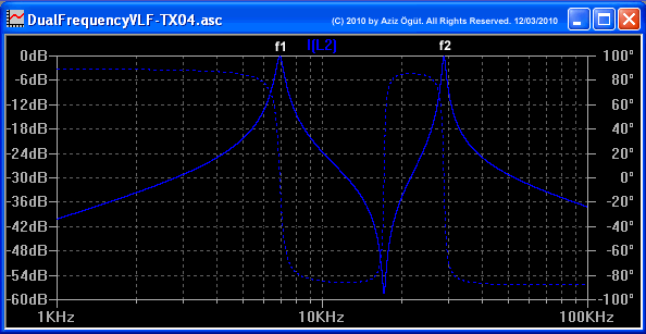

                • Dual Frequency VLF Detector
                  Hi all,
                  I have been working on a new type of VLF detector to kill the boring time. I am wondering, whether the new ground balance system can be transferred to this type of detector. As I have put all my equipment away, it will be a battery-less detector (passive coil again). I have only magnet wire, capacitors and resistors at home. This should be enough to start with a laptop/sound-card solution.
                  Below is the frequency response of the dual frequency transmitter coil. As you can see, it amplifies on two different resonant frequencies, which will be processed. I don't know yet, whether it will give a positive result.
                  The transmitter coil consists of two (less) coupled coils with a combined series and parallel resonant tank. It is very sensitive to coupling of the coils, which will hopefully make detecting reactive response and resistive response easy. The receive coil is seperate (induction balanced configuration).
                  I'll keep you informed, whether it is working or not.
                  Cheers,
                  Aziz

                        • New Idea on Dual Frequency VLF
                          Hi all,
                          no problem . There are many ways to get it working.
                          I will try to make the coil coupling zero. So one of the coils will be wound on a seperate ferrite core and the other one for magnetic field emissions (search head). It should give a better response this time.
                          The trick is to reduce the reactance on both frequencies (ideally making zero) so the frequency independent part of the impedance (coil resistance) gets only active.
                          If this will work, than I have a new very nice powerful and very simple detector. A simple power amplifier will push more current to the coil and a simple rx amplifier will do the rest.
                          Ok, let's make some more coils (bloody hell, I need a big ferrite core).
                          Aziz

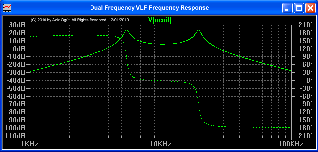

                          • Hi all,
                            I should remember you about the inductive reactance XL:
                            XL = w*L, w=2*PI*f,
                            where f = frequency, L = coil inductance
                            The impedance (=frequency dependent resistance) of the coil is
                            ZL = RL + jwL (complex notation)
                            where RL = coils DC resistance
                            So, if we have a simple coil (coil only) and have a voltage source (like an voltage amplifier), the current through the coil will be frequency dependent. The higher the frequency, the lower the current through the coil (impedance ZL gets higher). If we want two frequencies to be passed optimally through the coil, we have to make the XL almost zero on these frequencies. So the higher frequency part needs a higher voltage from the source but we usually haven't the higher voltage source. We will make the higher voltage through an another coil and capacitor (like a step-up converter).
                            BTW, we could take a current source and pass it to the plain coil. But then, a higher voltage is again necessary to implement the current source.
                            Ok, there is a very simple solution possible:
                            A parallel resonant tank (chocke with parallel capacitor) is connected in series with the voltage source. The search coil gets now very simple having only one coil and a series resonant capacitor (series LC circuit). The choke resonant tank can be placed near the voltage source.
                            Below is the frequency response of an ideal solution (the current through the search coil is shown this time, which really counts).
                            Aziz
                            • Hi all,
                              another issue on the coil current at frequency f2 (regarding last picture):
                              This would induce a much higher target response of course (direct proportional to frequency), so the magnitude can be lowered to avoid the rx amplifier overload. It could be better to have almost same target response for f1 and f2 at the end.
                              But the interesting question is:
                              Is there any useful information, which can be derived from the response f1 and f2 to make a good ground balancing and iron mineralisation rejection?
                              I don't know the answer yet. Let's investigate this.
                              Aziz
                                Hi all,
                                Aziz
                                Hi Aziz
                                what is basic circuit idea behind this? I am not sure if I am understad functionality of this frequency response diagram mapped to real world of circuit.
