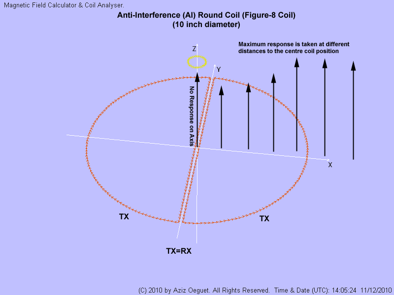

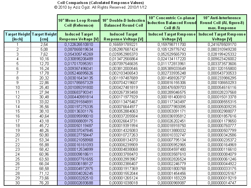

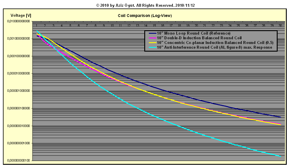

          • Added Anti-Interference (Figure- Coil
            Below is the new added coil type:
            - Scheme of the Anti-Interference (figure-8 ) coil
            - Coil Comparison of Response Values
            - Coil Comparion (Log-View)
            So, it's not going deep. But I have a novel AI coil, which will outperform the mono coil due to effectively no EMI and compensation with less gain only.

                    BTW, the log-view is a logarithmic display!

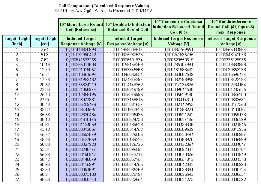

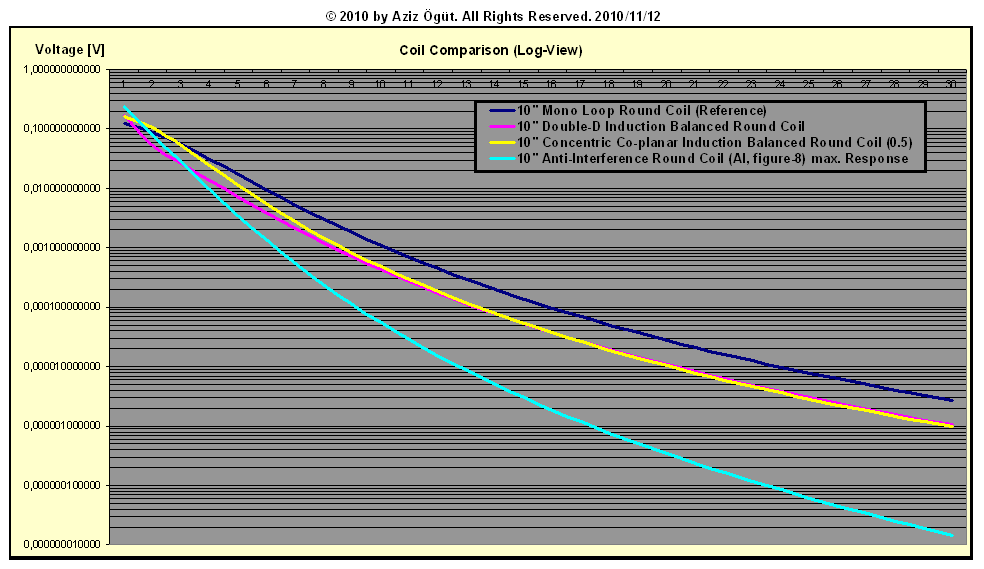

                      • Ahhhhhrrrrrggg! Found the guilty one!
                        This happens, when making some quick changes for experiments.
                        Code:
                        E2.iExciteType = EXCITE_CURRENT;
                        //E2.fExciteMag  = CCTXTG.fUind / CCTG.fZL;
                        E2.fExciteMag  = CalcTargetCurrent(CCTXTG.fUind, CCTG.fZL, CCTG.fTC, pElectric->Frequenz);
                        I have tried something in the function CalcTargetCurrent() and forget to undo it.
                        The target current is calculated E2.fExciteMag = CCTXTG.fUind / CCTG.fZL, which is commented above.
                        Now I get reasonable voltages and they matches spice simulation results.
                        I bet, the comparison is still the same. But the voltage levels should be now higher.
                        Ok, let's make everything new and put the data into the tables.
                        Thanks Tinkerer, this was a good one.

                          • Corrected Calculations
                            Finally, everything is calculated once more. This time more accurate.
                            The error was just a constant factor in the target current calculation. So it has no effect on the comparison. It's just a y-shift in the log-view. The values should be reasonable now. You can look at it if you want this time.
                            Let's make better coil designs with the corrected software version.
                            Aziz
