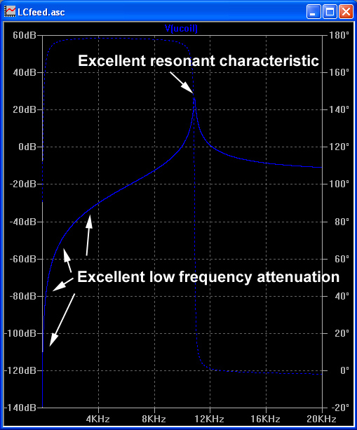

                Enclosed the AC signal analysis (frequency response on the coil). There is an excellent frequency response to minimize the 50/60 Hz, 100/120 Hz line injected ripple noise. Also the 1/f noise will be removed excellent.

                    Yes, that's true. I have increased the Q of the resonant circuit much. This is a typical narrow band filter. And this is predestined to lock-in amplifier to react to phase and frequency changes.
                    It makes sense to use HF litz wire for the search coil to minimize the coil losses (higher Rpar).
                    I will make more simulations on multi-pole resonant filters.

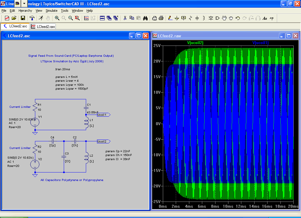

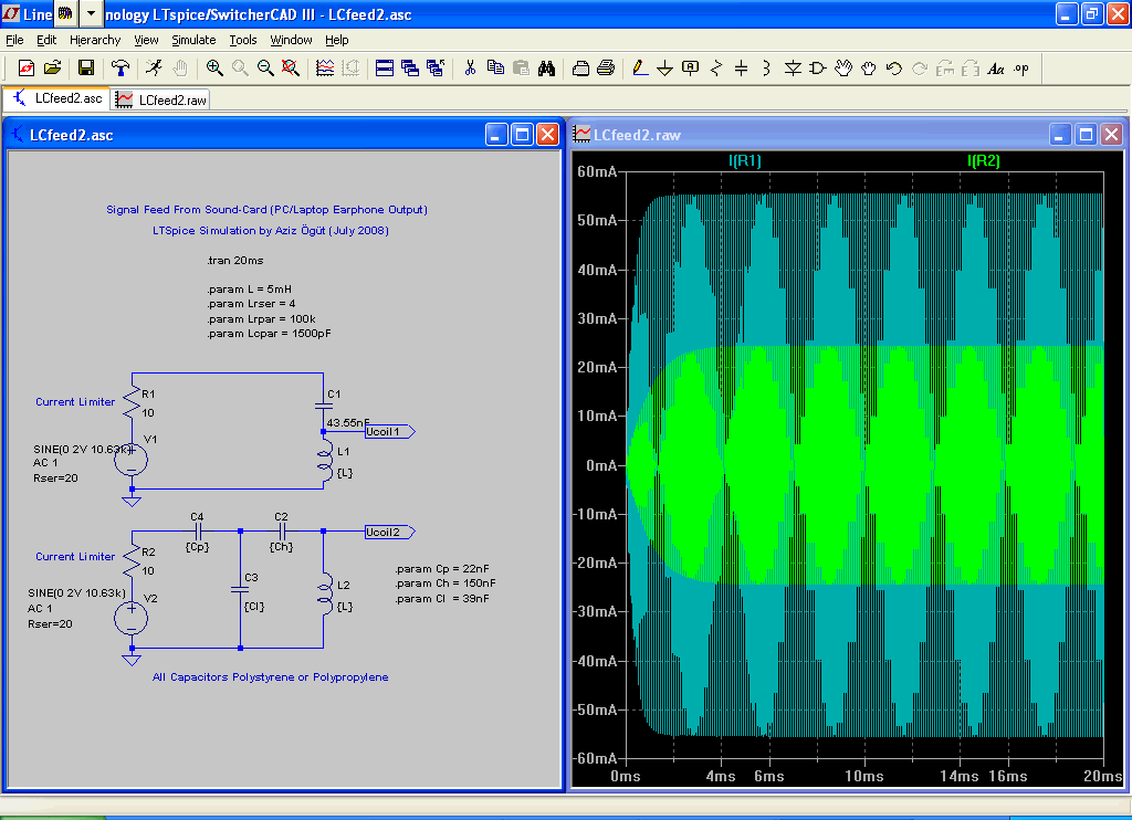

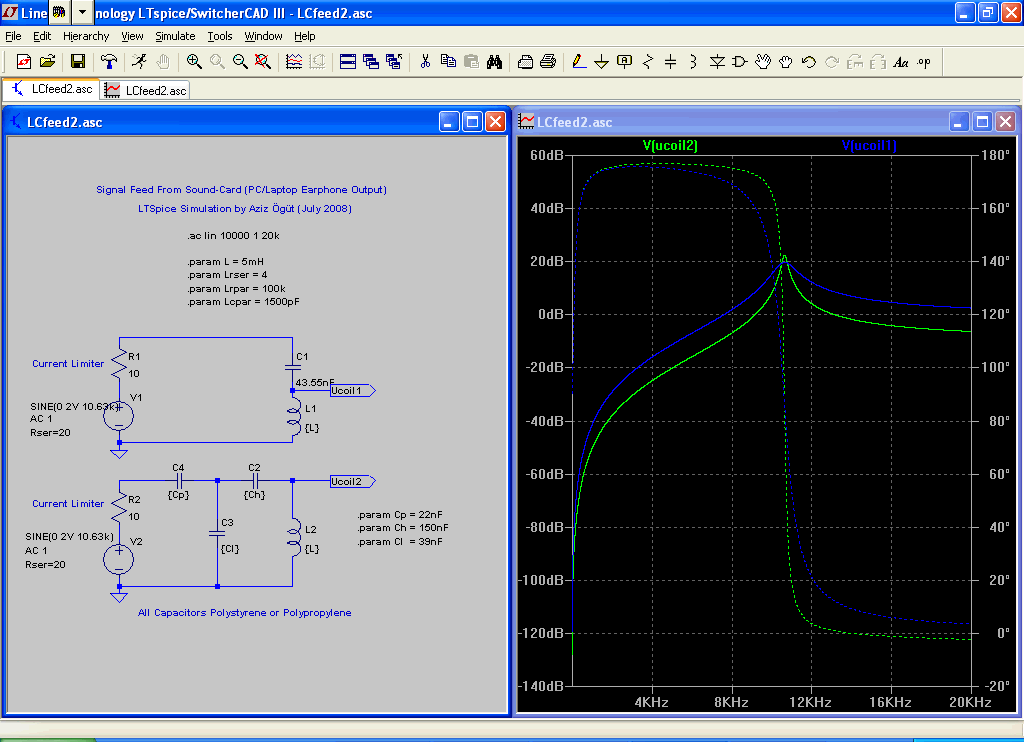

                    • Hi guys,
                      here are some interesting spice simulation results and the example feed circuits. It compares the normal series LC feed with the proposed one (I don't know how it is called). Both circuits take the same signal source (earphone output, 20 ohms impedance, ±2V = 4 Vpp) and the coils are exactly same with same parasitric characteristics. C1 of the first circuit is matched to have the same resonant frequency of 10.63 kHz. See the coil parameters on the attached picture.
                      The proposed circuit will load the signal source much lower than the first one despite of more voltage and current on the coil.
                      The current limiting resistor R1, R2 is necessary due to zero impedance of the resonant circuit.
                      Other combinations of the capacitor values could have better frequency response. If you like, then try to find a better one.
                      Enjoy,
                      Aziz
                      • Enjoy is correct! This is very interesting.
                        I have been thinking about coil resonance, maximizing current, and saving energy for a while.
                        Here is a question/comment: Correct me if I'm wrong: I understand why the current limiting resistor in the series resonant circuit, because at resonance the impedance of the LC goes to zero. Theoretically we can use a very high limiting resistance and still have a large current in the coil because it exchanges current and energy with the capacitor (I think) without going through the resistor. If we make the current limiting resistor low, we just waste energy in the resistor, there is probably a good trade-off value we want to find.
                        But I don't think we need any limiting resistor with the parallel resonant circuit because the impedance of the LC goes to infinity - the current in the coil is only limited by the Q of the LC. I guess if the Q is very high, the current limiting resistor doesn't play much part anyway, but better to take it away completely, no?
                        Just some thoughts without calculations. I'll try to do some calculations and correct my thoughts if I understand it differently.
                        • I am adding this new comment: my above comments probably may not apply to your circuit because you chose capacitor values that make it behave more like a "series resonant" circuit than a "parallel resonant" circuit.
                          So my new question is: suppose you simply substituted a parallel configuration for the series configuration without the extra feed capacitors in your very first diagram, and also remove the current limiting resistor. You would need to assume some Q for the LC circuit. In other words, what is the difference between a basic series LC configuration and a parallel LC configuration for use in a metal detector?

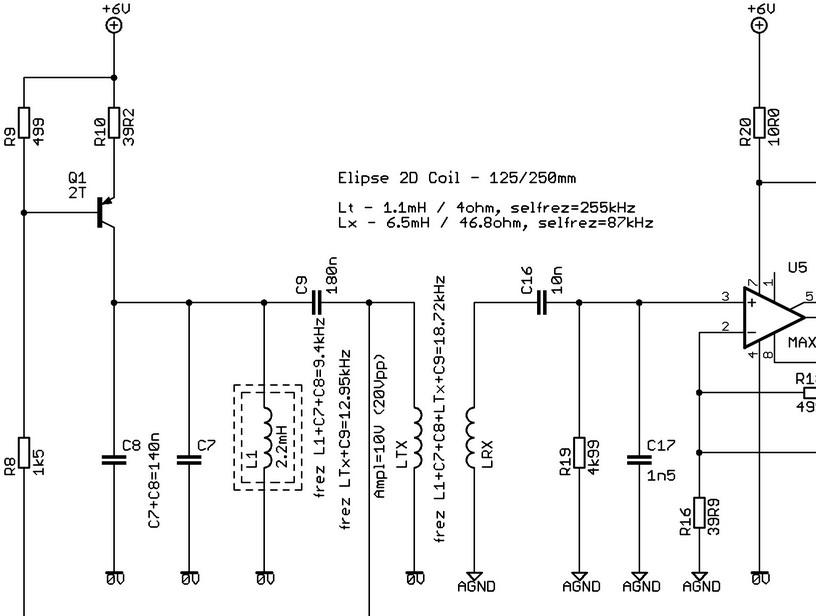

                            • Maybe I will give the new impulse in the discussion reminding the TX circuit Troy X5.
                              Mrand

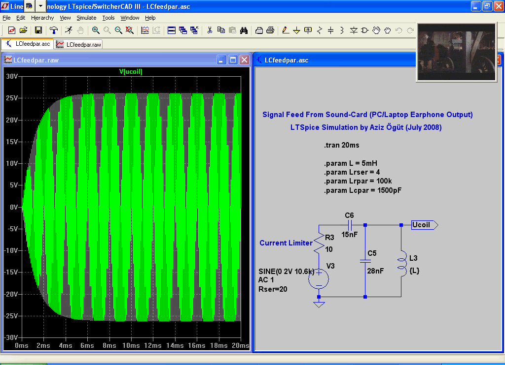

                              • Hi,
                                a parallel LC feeder shown in the attachement below has similar characteristics with less components (two capacitors). So this can be seen as an improvement of the proposed circuit.
                                The capacitors C5/C6 and the inductor L3 defines the resonant frequency. Has anybody interest to write the complex equations for this?
                                Aziz
