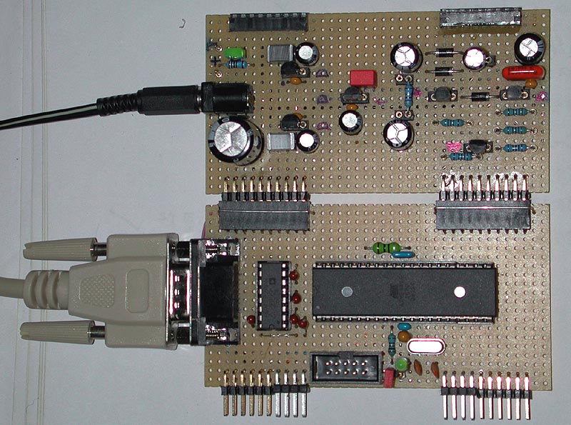

    • Hi all,
      the micro controller board with serial interface is running. Now the project can be pushed forward. At this stage, firmware coding becomes an important part of the project. I will implement a boot code later, which makes the programmer obselete (updating firmware with the laptop software through the RS232 interface).
      I took the A-grade of the MAX232, which can exceed the 115 kBaud rate (supporting upto 200 kBaud).
      Aziz

      • Here is the picture:
        • Hello friends,
          I have some important design warnings!
          Common ground short circuit. I didn't plan to use the RS232 or USB interface from the beginning of the PC-PI (laptop PI). As I took the sound-card ground to my + Battery, problems occur with the negative supply rail of the micro controller and RS232 interface. The RS232 interface has also its ground potential (=usually same as of sound-card) thus making a short circuit to the negative digital power supply. Be aware!
          Some restrictions occur due to this effect:
          - left the ground shield of RS232 potential free (not connected). The shielding will work anyway.
          - connect a current limiting resistor between pin 5 of the RS232 connector (pin 5 = RS232 GND) with the board ground (+Battery).
          A resistor up to 4.7 kOhm should work with the RS232 interface (already tested). If the high speed baudrate is used, this resistor may be decreased down to 1 kOhm (if communication doesn't work). There will be a small amount of ground leakage current due to different grounding (it is not a different ground - it is exactly a short circuit). At 4.7k resistor, I have measured a current of 2.6 mA. If you don't use the current limiting resistor, you will very likely blow out some parts.
          This is only a workaround, that might be used. I had the choise of making either sound-card ground or the RS232-ground low impedance and the decision is made for the sound-card (analog signal ground). The communication isn't critical and will work with the high impedance grounding as well. This allows me to keep the system design without much changes.
          A better solution would be making a level shifter between the ATmega and the MAX232 chip (TXD, RXD signals). The MAX232 chip has to be operated on the positive supply rail then. Both groundings can then be low impedance.
          So I strongly recommend not to build any circuits of mine! As changes happen often, critical side effects arises!
          No, I didn't blow up any parts. I knew of this fact before.
          Aziz
          • Hi all,
            I have tested several baud rates up to 115.2 kBaud. The 4.7k resistor is working so far. But it might out of the RS232 specifications and might not run on other PC's/Laptops. I will replace the RS232 with an USB interface later (with an appropriate grounding solution).
