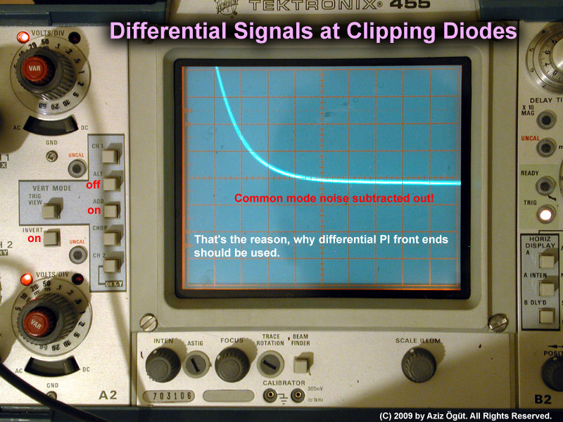

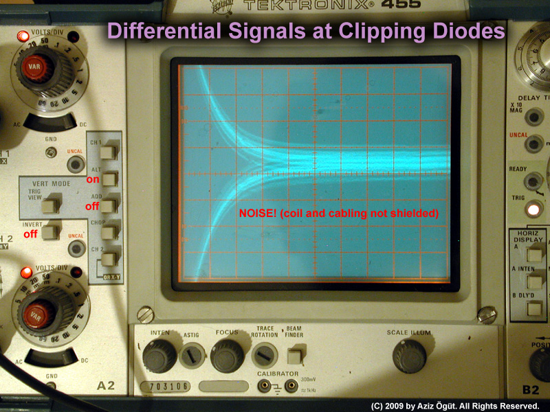

      • Hi all,
        I want to show and encourage you, why I am following the differential PI front end. First picture taken at both coil ends at the high voltage protection clipping diodes. You see the balanced signals, which are heavily overloaded with some noise (common mode noise perhaps?). The coil and the coil leads are not shielded. A single ended PI front end would process only one of the signals.
        Now see the second picture after removing the common mode signals (noise?). This is easily done within the scope by inverting channel 2 and adding both channels together (result CRO = ch1 + (-ch2) = ch1 - ch2 ).
        Can you see a significant improvement?
        Aziz
