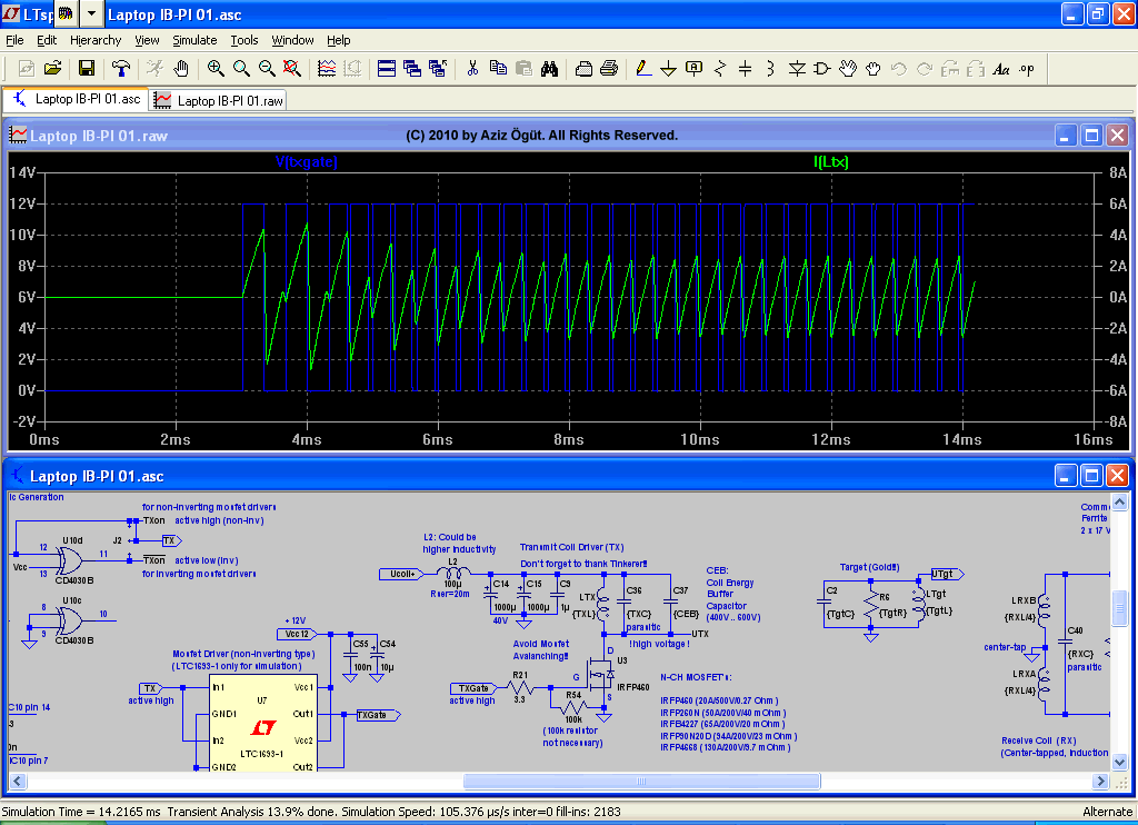

    Hi all,
    below is a ZIP-file, which contains all relevant files for a LTspice simulation. I recommend you to play with it to understand the marvellous transmitter in action.
    I have put my LTspice in "Alternate mode". To speed up the simulation, I have replaced the system voltages, as these take large time to get built up. It otherwise could cause convergation troubles.
    It is the full schematics of the Laptop IB-PI of the first cut. It takes some time to get stabilized operation (>15 ms time). The coil transmitter is a self regulating circuit. Somewhere later, the clock signals will be switched off (testing the absent clock signals).
    Have fun with spice simulations.
    Attached below:
    Picture of a running spice simulation.
    Spice simulation ZIP-file.
    Aziz

        • Aziz thank you for all your efforts and kind & clear explanations.
          Two question:
          1.) Why you do not exchange L2 by proper power diode?
          2.) Mean "Avoid Mosfet Avalanching" the same as "Avoid Mosfet Leak", what is adequate German term?
            the INA163 is causing some problems. The low pass filter with the feedback capacitors Cfb2 are causing some trouble and do not work in this case.
            Hi Aziz,
            if you wish to try with INA121 I would be glad to send you 2 or 3 pieces to experiment. Please check its data sheet for first view if you do not know this op-amp yet.
            • Hi WM6,
              Two question:
              1) Of course, you could place a forward biased schottky diode. But every diode has a forward voltage drop. Multiplied with the flowing current is the power loss. An inductor is much more efficient (=less power loss).
              Let's make a comparison at 1 A current drain:
              Diode: (Schottky: 350 mV voltage drop), P loss = U*I = 0.35V*1A = 0.35 W
              Inductor: (Series resistor: 50 milliOhm), P loss = I²*R = 1A*1A*0.05Ohm = 0.05 W
              The inductor is much more efficient.
              That's also the reason for, why in the enhanced Phase 4, the mosfet is switched on again to omit the voltage drop of the internal body diode.
              2) Avalanching means, if the Drain - Source voltage is exceeding the specified max. voltage limit. It will break down then. The mosfet will be conducting during the higher voltage period. If a mosfet is only specified for 200V, the flyback voltage may not exceed this level. But the breakdown voltage is temperature dependend and you need some spare not to exceed its maximum voltage level.
              Well, its not a problem, if the mosfet avalanches. Just increase the coil energy buffer capacitor. It would have a positive effect: eddy current frequency spectrum will be lowered and the eddy currents can penetrate the target deeper. So the target can store effectively more energy, which will last longer for detection.
              But if the mosfet breaks (avalanches), a lot of energy will be lost and heated up in the mosfet.
              Avalanching in german? I don't know. Maybe: "Durchbruch"

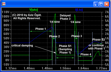

                              • High Efficiency Mono Coil Transmitter Signals.
                                Hi all,
                                below is the delayed phase 3 for mono coil configuration PI with efficient energy recovering described above. The delay is called phase S1. This phase is critically damped (damping resistor switched in, coil energy buffer capacitor switched out). After the damping, the samples can be taken directly from the TX coil. The delay period can be as long as necessary. The coil energy will be held in the capacitor during this time.
                                After the samples has taken, the phase 3 will be continued to recover the energy back. If the Phase 4 is finished, either another sampling is possible (phase S2) or it can be continiued with Phase 1 for continious operation.
                                Ignore the voltages and currents after phase 4. The control signals are not set and the coil has some minimum energy that begins to oscillate. The minimum energy left back in the coil or capacitor can be damped with the damping resistor if there is another sampling phase (phase S2).
                                The principle is quite high efficient and makes pure mono TX coils possible. If you don't make the damping resistor switchable, some energy will be lost. Best efficiency will be given, if the damping resistor is switched in at its usage only.
                                Aziz
